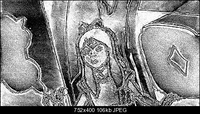

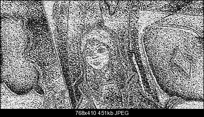

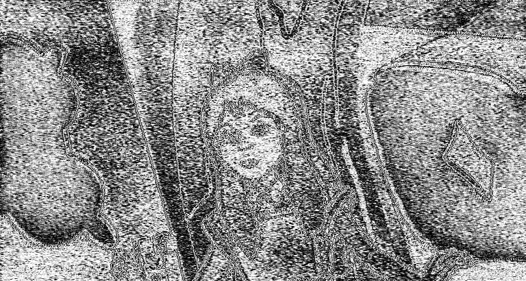

    Result:
    (1st: fft3d, 2nd: neat, 3rd: original, 4th: deshake (jagabo)

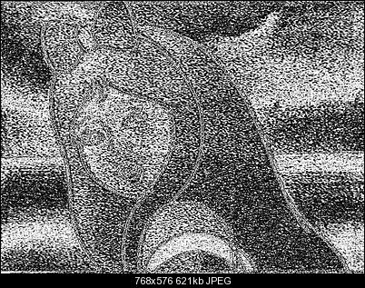

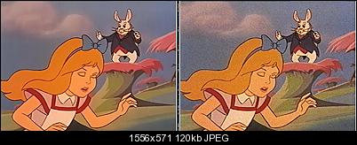

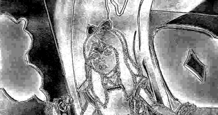

  6. Originally Posted by zerowalker View Post
    Okay, i used a crop one, forgot i had cropped it...
    Here is Another part i had though.
    Result: http://www.sendspace.com/file/s215u4

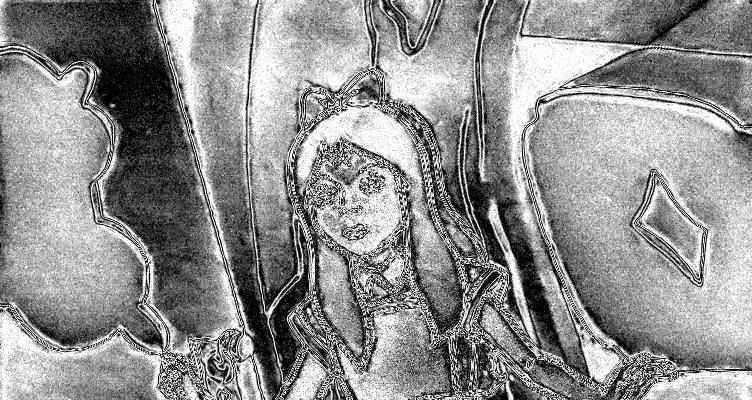

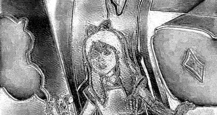

    analysis:
    original
    result:
    result vs og :

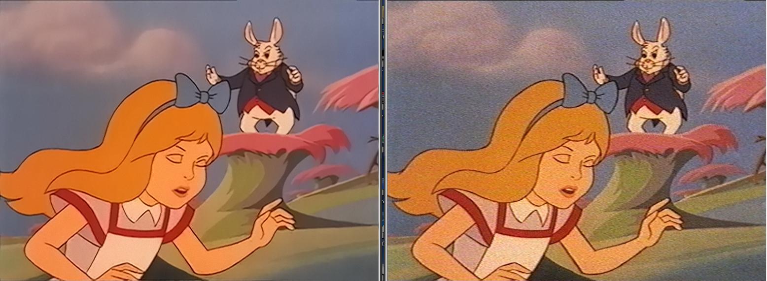

  7. FWIW, here are mine using free filters only. If you like it I can post the script

  9. I think I messed up the colors in my 1st attempt, I find it difficult to color correct in avisynth (I would normally use another program, or even vdub curves or colormill; the reason is you can do non linear adjustments a lot easier) . I went by assuming the sky was supposed to be blue instead of the reddish hue, and the apron part of the dress was supposed to be white. I attached one with better colors
    I think I used weaker denoise settings than themaster1, but you can always the settings or strength of filters adjust to your tastes. I didn't stablize it either, but you can use stab() like jagabo suggested, or deshaker in vdub, or depan
    Some notes:
    Your video has duplicate frames. This is common in anime. The real fps is 12.5, and every 2nd frame is exactly a duplicate. It's important when using temporal filters to decimate the duplicates beforehand, because they examine for differences between frames. This has added benefit of processing a lot faster because fewer frames to process. e.g. You can use selecteven() or selectodd() .
    You can encode with the double pulldown flag using x264 - this would be slightly more efficient (1/2 the frames to encode, but it's not a linear gain), but many media players and devices don't support this. So a "safe" way would be to re-double the frames after processing filters e.g. interleave(video, video) , or another option would be to encode the video as 12.5fps with unique frames.
    Besides the reddish hue, and obvious noise, the other artifacts worth mentioning:
    1) Aliasing - looks like jaggy stair stepping edges. You can use antialiasing filters, there are dozens to choose from in avisynth. I used santiag in this example
    2) Chroma Bleeding - the color doesn't fit inside the lines, it's almost as some pre-schooler screwed up coloring with the crayons. I think you were referred to this as the "aura" . You can use MergeChroma(Awarpsharp) for this
    I broke it out into stages with lossless intermediate in between each, but you can do whatever you feel like. As ususal , adjust to your own tastes. Some prefer super clean anime, some prefer lots of detail remaining and don't mind a bit of noise . I think you will get better color results using non linear adjustments (e.g. curves)

    This will return 12.5fps, with unique frames. If you want to encode at 12.5 fps, go ahead, or duplicate the frames
