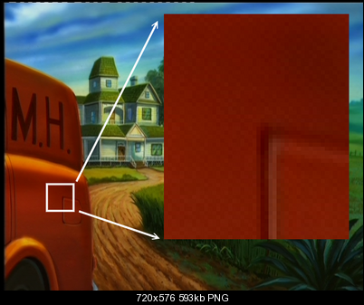

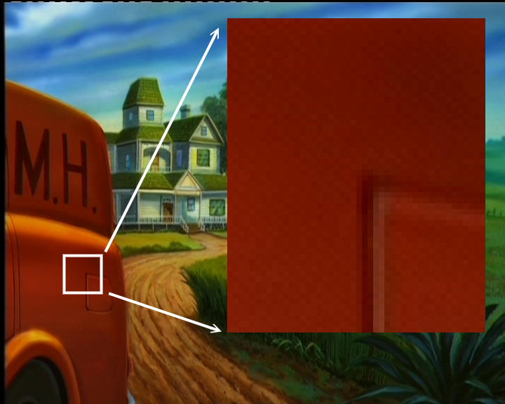

    What's with this FUD? Yes, TBC-1000 adds AD and DA conversion, more cables and connectors and other stuff to the signal path. It's high freq response is not optimal (VHS doesn't fall in this category). It's not perfect by any means. But we're talking small budget VHS transfers here. Those quoted statements are misleading and gross exaggeration.
    Attached you can find 2 screenshots. One is a direct capture, other is thru TBC-1000. Which one is "DESTROYED" in your opinion?

    So get a TBC-1000. Plenty of people use them. How is that supposed to help correct line timing and burned-out highlights?
    The bottom image looks as if it has been sharpened later.
    Nov 2008
    Finland
    If you read up this thread, TBC/Frame sync was brought up in relation to Blackmagic capture device which doesn't work with VHS without one. Both pictures are straight from device.
    edit: Watch them in 1:1 size, browser scaling sucks.

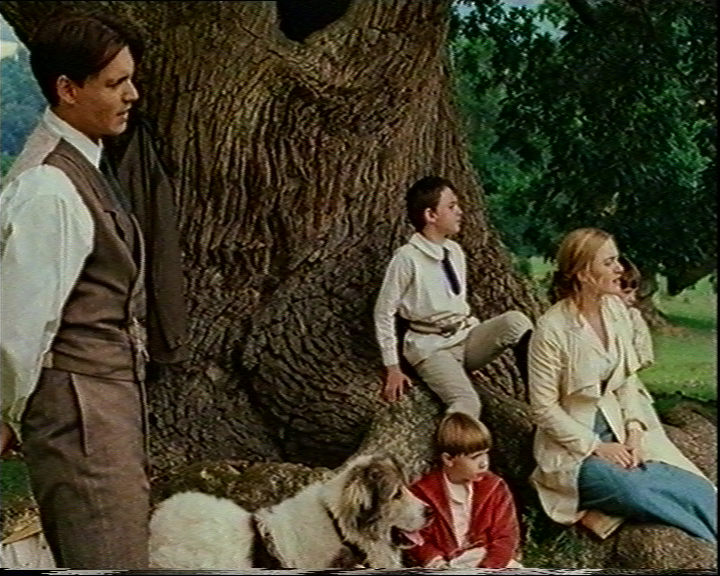

  14. Originally Posted by sanlyn View Post
    I still don't see any herringbone from either unit.
    Toshiba:
