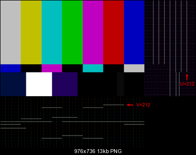

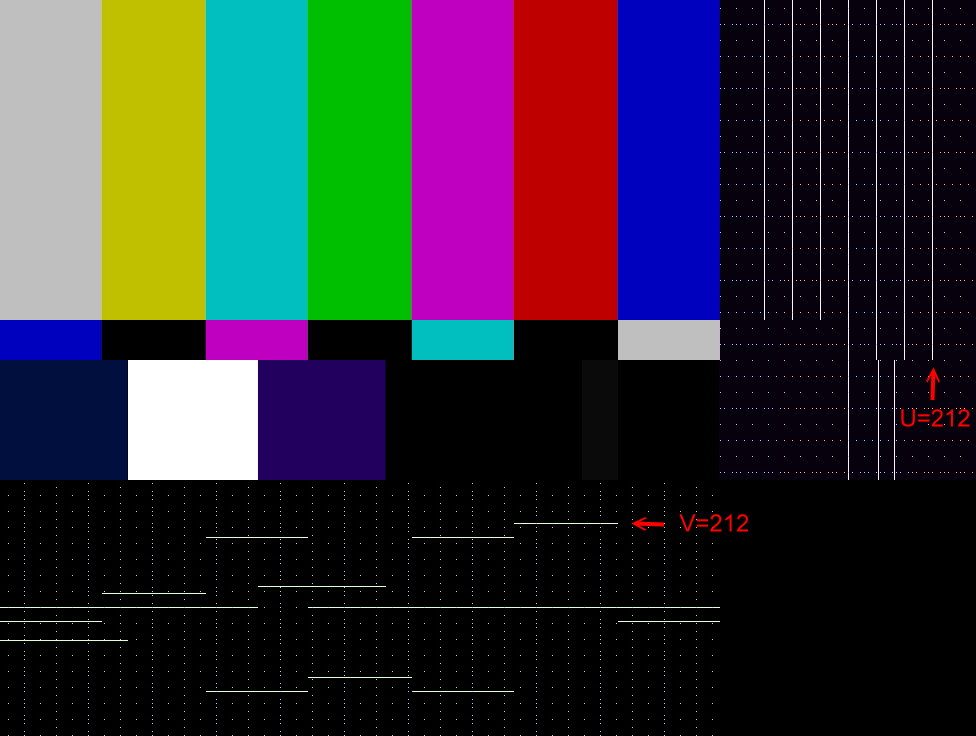

  2. Because that is the max value of U and V in the chart:
    U from the blue bar, V from the red bar.

  6. i don't see which colors you're refering to jagabo frankly
  7. Originally Posted by themaster1 View Post
    The blue bar has U=212, V=114. The red bar has U=100, V=212. 212 is the maximum value of U and V in that entire image.

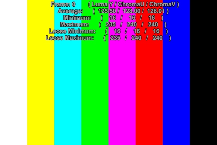

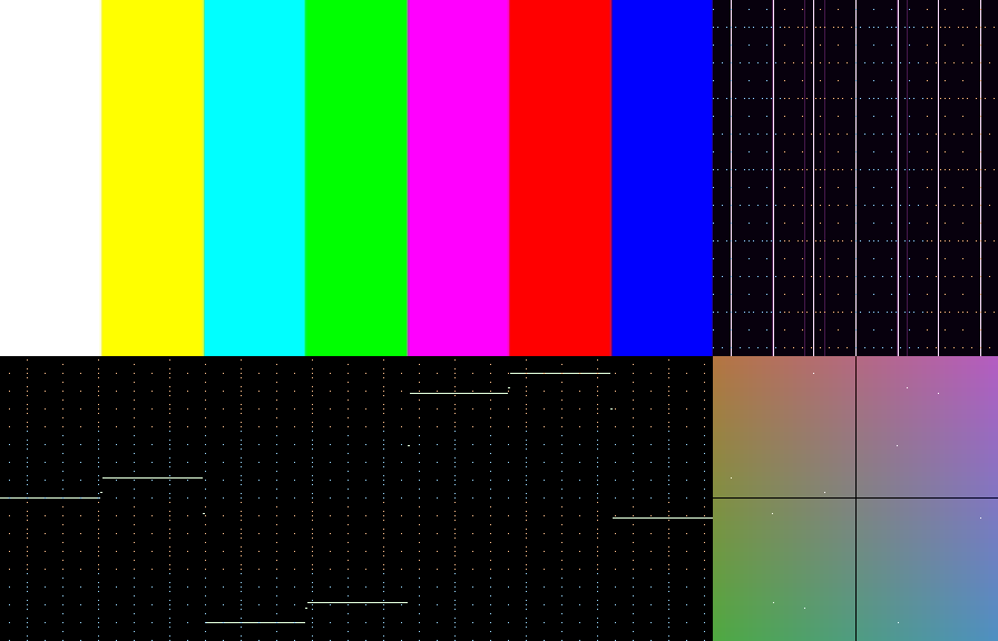

    Similarly, for 100% color bars , the RGB values when converted with Rec601 would be the same as above, just replace the 191's with 255's .

  18. Thank you for confirming what i thought poisondeathray, 16-240 that's for full scale (aka" full swing") yuv
    rec.601 (SD: TV, DVD,VHS) / rec.709 (HD) = broadcast safe (studio swing) = 16-235 / 16-212
    How do you generate a 100% color bars pattern in the first place ?

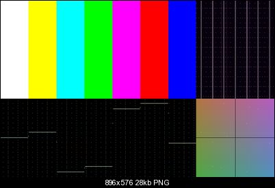

  19. For the color bars only:
    ColorBars(pixel_type="RGB32")
    Crop(0,0,-0,-160)
    RGBAdjust(r=1.67, g=1.67, b=1.67, rb=-32, gb=-32, bb=-32)
    ConvertToYUY2()
    Or you can just build them with an image editor in RGB and ConvertToYUY2().

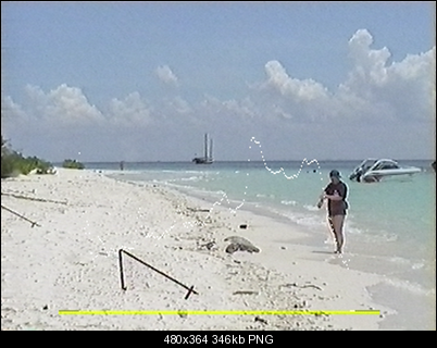

    ds014.avi doesn't look so great, and parts of it are wrecked. I don't refer to the over-white frames; those are obviously a disaster. That auto brightener shoves even the midtones off to the right and severely clips the brights. Ut also comprtessed the midones and brights into a narrow band that crushes much detail and makes vague mush out of many contours. Unfortunately the AGC doesn't stop the clipping or the compression; it merely darkens what the whitener compressed and clipped (i.e., crushed

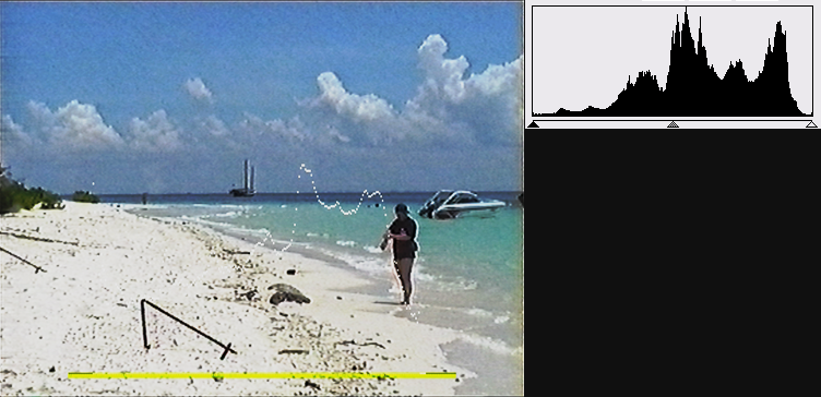

    Image 186 is one of the AGC-corrected frames. It is washed out, and has lost saturation and depth. You don't need a calibrated monitor to notice the results. The histograms and waveforms tell the story:

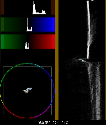

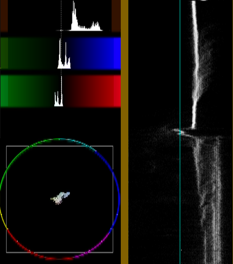

    YUV histogram, vectorscope, waveform from original frame 186:
    Upper left: the YUV histogram shows luma (and colors) compressed into a small area on the right-hand side; midtonesm whiuch should be near somewhere near the middle, are over-brightened and crowded into a tiny column (which is another form of clipping).
    right-hand side (YUV waveform): midtones would usually lie along the green line down the middle of the column -- darks to the left, brights to the right. You can see that midtones are in a small peak near the middle portion, along with some of the darks and lower midtones that have been over-brightened. This is another bway of saying that there is very little midtone or dark detail where it's supposed to be. The image looks overexposed.
    lower left (YUV vectorscope): Image data is compressed into a little blob.

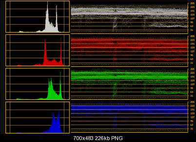

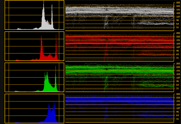

    RGB histograms and 'scopes, original frame 186:
    left (rgb histogram): compression and clipping are shown onn the rightr of the histogram. Right (rgb waveform): the thick bands show the affected areas. Details rapidly dissipate toward the bottom of each section.

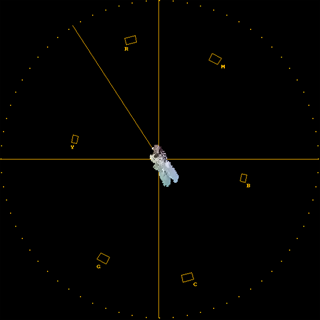

    frame 186 original, rgb vectorscope: AAs with the YUV vectorscope, color and luma are compressed into a small low-saturation area.

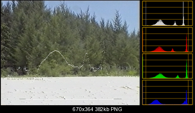

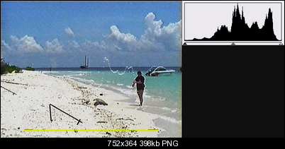

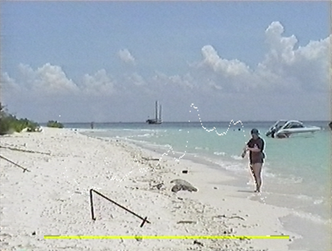

    An attempt to restore some color and luma range tp "auto-corrected" frame 186 and make it appear more natural. Rather difficult, becaue stretching midtones does restore some midlevel detail, makes the grass on the left look more like grass, makes the distant boat and standing figure more distinct, and reveals sky and cloud details that were compressed and smashed. The RGB histogram (from Photoshop) shows how luma and color were stretched into a more natural configuration. Banding and mottling from the compression are apparent in the sky and water.

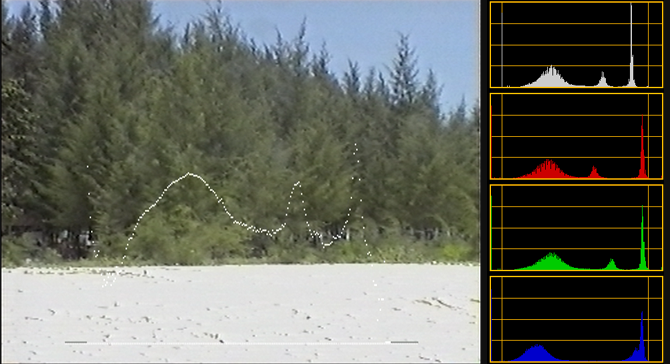

    Frame 663 is the original Auto-corrected frame. The rgb histogram to its right shows compressed midtones, and on its far right you see the high peaks of clipping. AFC darkened them, but the brights are still clipped (look at the sand). Midtones and shadows in the trees are too bright.

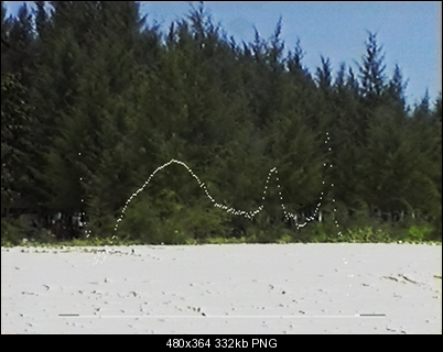

    AGC level changes will affect the filters used to expand the image. The image below is frame 663 using the same correction filters used for frame 186 at the start of the clip. Here, the same luma and color adjustments make the shadow detail more obscure. You can fix them, but the adjustments will also affect frame 186, making its darker objects too bright again. With AGC changing levels unpredictably, you can't use the same filters throughout the same camera shot. And the brights, although slightly darker, are still clipped. Your own histogram in the image shows the clipping point.
    Yeah i know that the "White Crush" makes it, well, Lacking Life so to say.
    But you see what happens if i turn it off, it totally clips the contrast, even though itīs within the YUV range, and i canīt control it with anything else.
    Though White Crush isnīt your normal AGC i think, itīs a must have in capture devices that captures Analogue i think, though mine is badly configured on default.

  27. Yeah, the BT878 cards got it aswell, and well, itīs as you say, there isnīt really a good explanation, like:
    If you get this, set it to that etc.
    There is 4 settings for White Crush:
    1: White Crush(On,Off)
    2: White Crush Up (1-63) = This is at 15 by defauly, and i kept it there.
    3: White Crush Down(1-63) = Itīs normally at 63, but for me thatīs waaay to slow, it takes to long time for it to react, so i changed this to 15.
    4: White Crush Majority Point (Automatic, 1/2,1/3,1/4) = I did a test, and i canīt see any real difference, though i think that 1/4 is the "best".
    5: White Crush Per Frame(On,Off) = I think if itīs off it changes to Per Field, and is alot faster at reacting. ( I use it Off)
    I seem to remember you sying that you were turning at least one autom filter on and off, and I had then idea you were actually using two of them.
    Oh, maybe i did say it, but i didnīt use anything on that Beach clip except turning of White Crush (with the settings above) on and off.

    @jagabo, looking at the PDF I'm looking at White Crush "Up" and "Down" Registers. Is that what we're referring to? (Not that what I'm looking at makes much sense, anyway). I'd request a cap of that video as-is, or none of us will know what we're talking about.
  29. Banned
    New York, US
    OK, so if you tried various settings we still don't know how the video looks that you're trying to correct. But when you say the control is "slow", you mean that it's slow to react to changes, not slow to feed frames to your capture (I hope).
    I think I get a new impression here, you're saying more clearly now that when the video is at its brightest points, that's what it looks like without any capture processing at all?
  30. Originally Posted by sanlyn View Post
    look at my clip, when it goes from "normal" to Super White, thatīs when the White Crush is Off = Nothing changes the picture.
    And when i say itīs slow, itīs when the image is white, it shouldnīt take 10 secs or more to "fix" it, but with the default settings it does.
    The werid thing is though, that when itīs down at the "good level", it never really goes up, so i can pretty much have 0 on both Up and Down, the only thing that can ruin is if it flashes to white, (when i change from Composite to S-video for example), it will go Super dark, but that fixes with turning it on and off.
    Though, in the end, using it with the settings i have now, seems the best, it doesnīt Over darken, and it isnīt slow.
    Though i would be glad to understand what the stuff really does, i mean what should it be doing?
    I am only changing what i think is good, i donīt know what to "calibrate" from;S
