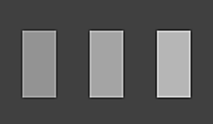

    Here's an example of oversharpening halos:
    Instead of a smooth transition from one gray level to another there are lighter and darker bands at the transitions. This is common for VCRs because they are inherently low resolution. They try to look like they have more resolution by applying a sharpening filter (along horizontal scanlines so you see the result on sharp vertical edges). You can try using BlindDehalo3() to reduce these.
    You can see oversharpening in the TBC example too. Those were originally sharp white lines on a gray background. After recording and playback via VHS they acquired the obvious black halos.

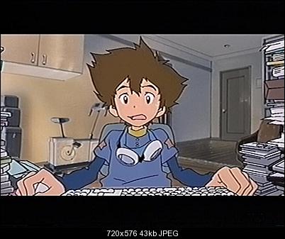

    Instead of McTemporalDenoise() try using TTempSmooth():
    AviSource("Original 1.avi")
    Blur(0,1.0).Sharpen(0,0.7) #clean time base jitter
    TTempSmooth(maxr=7, lthresh=50, cthresh=70, strength=7)
    You'll have to play around with the TTempSmooth() settings. Those are pretty heavy and you may find ghosting in some shots.
    AAA() afterward will clean up the outlines a little more.

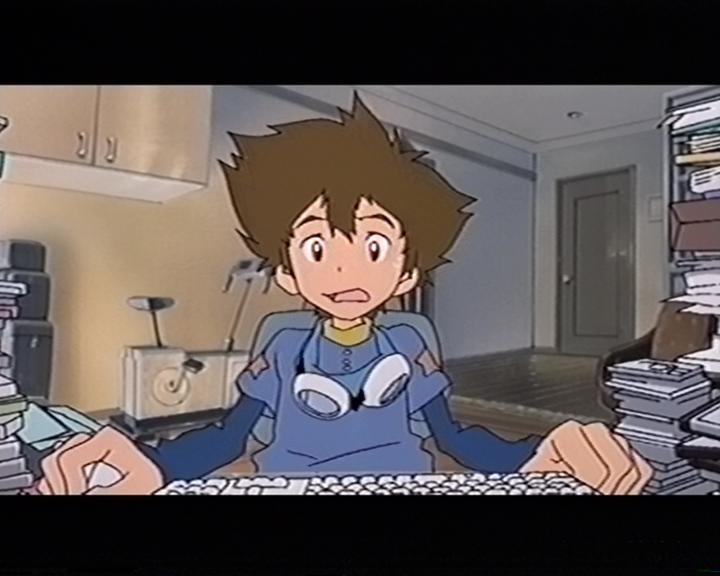

  16. Hmm, using the TTempSmooth showed interesting results, but it seems that i am not capable of producing it without getting the ghost lines effect from what should be moving, i used AAA(), though maybe i should use some specific setting with it?
    Well, will try playing around, a very nice but hard controllable filter

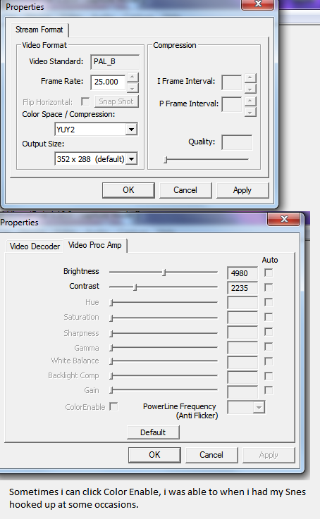

  17. Just noticed, that my card changes Contras and Brightness automaticly, it showed after i played Snes through it, as if it went dark, and then bright, it would be very bright, but it tuned down after awhile, is there anyway to force this off?
    And another thing, input screen can flicker blue if the input lines get waved, or how i should but it, not normally a problem, but wonder what i means. I can show some clips if you want.
    Played Link to The Past, when i used the mirror in the Dark World, everything getīs "waved into" the other world. That brought the blue flicker, but it seemed that changing resolution for the input helped with it, but i just played around, so probably fucked it all up:S
    Using a spacial noise reduction filter first will allow you to use much lower values in TTempSmooth().
    MSmooth(threshold=20, strength=2)
    TTempSmooth(maxr=3, lthresh=8, cthresh=8, strength=3)
    Again, play with the parameters to suit your taste. I prefer to leave a little noise as it reduces posterization problems.
    That is a problem with some ATI cards. My ATI 650 USB2 does the same:
    https://forum.videohelp.com/threads/326560-Which-is-better-usb-stick-vhs-cap-or-hd-pvr-...=1#post2023227
    It appears to be a problem with the Macrovision detection circuitry. The only way I've found around it is to use a "video stabilizer" -- a device used to strip some forms of Macrovision.

  21. VCR and Output Enable is grayed at the other window btw
