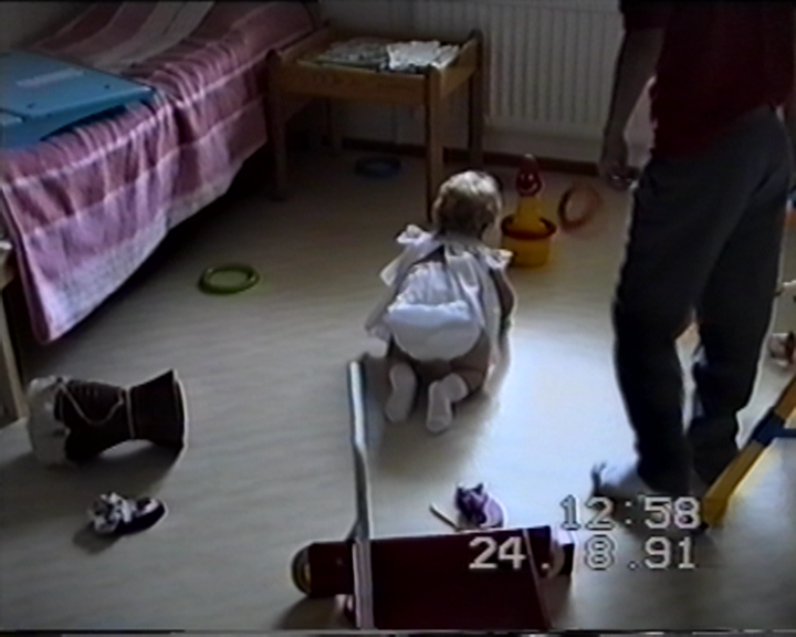

    I had no problem with QTGMC on the shimmer_raw clip. The wiggly lines can't be helped much with software. But I do see excess pixel activity on camera motion, mostly fixed with QTGMC and some low MCTemporalDenoise. The last of the motion gnats died after a touch of NeatVideo used only asa a temporal filter, other filter parms turned almost off. Edge jaggies and edge ghosting were obvious. Couldn't fix all of that with the time available tonight. The color balance is fairly awful, likely from tape deterioration: there's a green color cast, darks are crushed, blue is oversaturated. I fixed some interlace and edge jaggies quickly, but I finally gave up on discoloration, chroma bleed, and cyan staining. I keep cruising doom9 for solutions for those.
    Frame 47 of the original: in the entire image there's not a single clean black, gray, or white. The "real" colors are anyone's guess. Highlights were destroyed long ago, no way to recover them. The image looks oversaturated, with rather grim darks.
    [Attachment 12686 - Click to enlarge]
    After some ColorYUV, I used a VirtualDub gradation curve filter derived from loading this clip into the Color Finesse plugin in AfterEffects (still trying to get a firm handle on that app!). I'm not satisfied with colors yet, but levels are more TV-friendly, gamma still looks a bit strange, the gal keeps turning yellow and mama stays a dark purple-gray. But the woodwork looks like real wood. Anyone's guess what color the time/date characters are, but I don't think they're gray or white.
    [Attachment 12687 - Click to enlarge]
    Histogram from the YUY2 original. I can't say I've seen luma clipped at the left in quite this this way. First time for everything.
    [Attachment 12688 - Click to enlarge]
    The attached mpg is PAL 25fps interlaced. I used QTGMC (slow), then MCTemporalDenoise (Low, edge clean + anti-alias on), some very light NeatVideo at nearly temporal-only (I think I should have turned NV's Y-channel entirely off, 20% still looks over-filtered). Motion looks smooth to me. But a line-tbc and a better player would have solved a lot of problems.

  8. Sure thing download it from here: http://www.mediafire.com/?3mzcnxvcamohb4r
    I think it need more tweaking and i suggest you work with rgbeq and cmill a little more.

    It's done all the time. I used this:
    ##   ColorYUV omitted here.  ##
    ##       Input is YUY2
    FixVHSOversharp(30,14,10)
    ConvertToYV12(interlaced=true)
    AssumeTFF().QTGMC(preset="slow")
    MCTemporalDenoise(settings="low",edgeclean=true,ECmode="dehalo_alpha()",\
      enhance=true,AA=true,useEEDI2=false)
    # -- reinterlace --
    AssumeTFF().SeparateFields().SelectEvery(4,0,3).Weave()
    # -- more cleanup for aliasing and dot crawl --
    daa().daa()
    # -- restore 4:2:2 for further color work --
    # -- If encoding with HCenc, ignore this statement. --
    # -- Normally I avoid this, but it Worked OK here.  --
    ConvertToYUY2(interlaced=false)
    # -- crop bottom border noise and center image --
    Crop(0,0,0,-8).AddBorders(0,4,0,4)
    # -- use for RGB, NeatVideo, and TMPGenc only. --
    # -- Otherwise, ignore the statement below.    --
    ConvertToRGB32(matrix="Rec601",interlaced=false)

    Here are 2x bicubic enlargements of the date/time characters from the three sample clips: mine, the master1, and your processed avi -- but not shown in that order. Cleaning up detail like this would require more work, but these are initial efforts representing three approaches to processing. I'll leave up to readers to determine which image is from which sample.
    [Attachment 12697 - Click to enlarge]

  24. I think i have found a good compromise for this scene zerowalker:
    picture (original,previous tweaks, new tweaks):
    http://www.mediafire.com/?wsi3kkn92vg2g6k
    vdub config (include filters if needed):
    http://www.mediafire.com/?utyggnpad283i18
    video:
    http://www.mediafire.com/?0vg7d6a6cl3cwb9

  26. themaster1, your script is really complex, but it gives very nice resulst, though i donīt know how to tweak it, but the functions are the ones that really does some neat work, sadly i canīt get the NLMeansCL to work (AMD GPU).
    But i got one problem with your script in comparasion to dfttest, your gives ghosting, or itīs bad at motion estimation i think, and i donīt know how to tweak this.
    jagabo, yes i remember that one, i understand what itīs doing and even with just that information there i know that it will be a huge difference with 25 fps all over the place.
    does the ES15 have any problems?
    as i remember one needed some amp to get the right colors or something.
    is NV-HS 900 any good?
    or does it have some denoising stuff going on?
    Cause i Maybe can get my hands on one, if itīs worth it.
    Look at the red ring:
    First = themaster1
    Second = Mine Dfttest,motioncompensated + qtgmc
    Edit: My bad, was using Santiag for the Zigzag dot crawl, which breaks interlacing.

  29. Banned
    New York, US
    If in decent condition, the NV-HS900 is a very good machine.
    I don't see ghosting in either scene. Each image has its own good points, and with a tweak or two themaster1's script would produce results even more similar to #2. Both have edge ringing or halos. but that's not ghosting, which loo0ks almost as its name suggests: it's an offset, usually half=-transparent double image.. The red ring in the top image looks the same as that in the lower one, just not as much sharpening (that's easy to fix). Both have the same chroma smears (not easy!).
    How does Santiag "break" interlacing? It just doesn't work well on interlaced video.
    ghost example, from really awful DVD transfer. Note double image to right of figures and to the right of white diagonal lines:
    [Attachment 12705 - Click to enlarge]
    Fixed . . . well, almost. Not 100%. Detail is so poor to begin with, stronger filter would destroy more.
    [Attachment 12706 - Click to enlarge]
