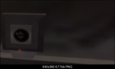

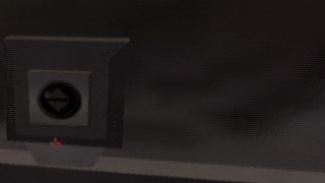

    I think you're talking about residual come artifacts on the grey wall. 2x point resize:
    If you turn off post processing, TFM(pp=0), you'll see that it happens because an interlaced frame has gotten through the field matcher. But the post processor didn't recognize some of the combing in the grey wall and let it through. You can try playing with the different pp modes. TFM() also has a decombing threshold setting you can try playing around with, cthresh.

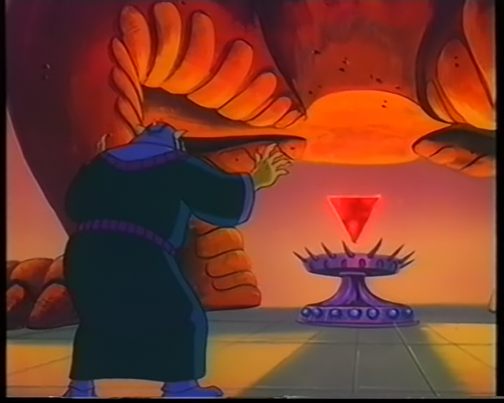

Name:	Zelda Del 1 - Test - 10 Bit.mkv - 00000.png
Name:	VTS_01_1.VOB - 00007.png

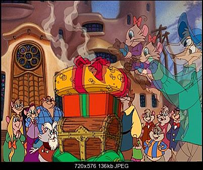

  22. I have problem Deinterlacing a PAL DVD, i tried QTGMC with Srestore, but no matter how i use QTGMC i get ghosting.
    Does anyone know why?
  23. Not all videos can be de-ghosted.
  24. Yeah but i donīt get it with TFM(), but TFM fails on some frames, it doesnīt deinterlace etc.
    And yeah, itīs cartoon, so i know that it may have Ghosting to make it "smooth" or how to put it. but it doesnīt seem to have it.
    And QTGMC creates ghosting even on progressive frames on the source;S
  25. If you want answers about a source, don't ask questions; provide untouched samples from the source. But as mentioned, some sources are so crappy they can't be fixed.
    QTGMC doesn't 'create' ghosting.

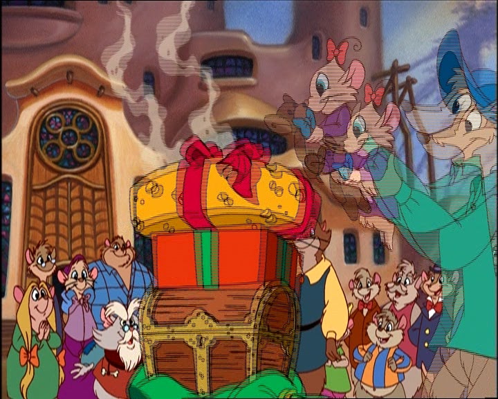

  26. Here is a sample
    And well QTGMC has created ghosting for me, when it fails to deinterlace, but TFM works then so itīs probably not interlaced i guess.

  28. Originally Posted by zerowalker View Post
    Here is a sample
    That video just has a weird cadence. Some of the original film frames last only one field, some two fields, some three fields, etc. I suggest you QTGMC() it an encode at 50 fps if you need it progressive. Or maybe, after QTGMC(), try TDecimate() in mode 2 or 7 to get some lower frame rate.

  30. Originally Posted by zerowalker View Post
    So itīs messed up interlace i guess, but do i really have to go with 50fps?
    Is it really that many real frames?
    Sanlyn, with that i mean it could be some meesed up interlace, not ordinary, which seems to be the case.
    The interlacing isn't messed up. It looks like the original was about 15 fps progressive. It has gone through some weird telecine pattern to get 50 fields per second. It may be hard to get it back to the original ~15 fps progressive frames without some duplicates and some dropped frames. Or it may be a mix of frame rates. So it's easiest to just encode it as 50 fps progressive. That way the cadence won't be any worse than the original DVD or broadcast.
