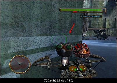

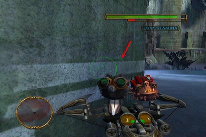

  3. Originally Posted by zerowalker View Post
    Here it is, try to deinterlace it, without getting the Aim (Green) so leak to the left.
    Are you talking about the way the green circle is blurred on the right edge? That's in the source.
    I do see color blending of the green circle after QTGMC(), the red arrow points at it:
    That is an error on the part of QTGMC. The color was too similar to the background so it didn't eliminate it. But that video is progressive. You should use:
    AviSource("Leaking.avi")
    AssumeTFF()
    SeparateFields()
    Trim(1,0)
    Weave()
    That will be free of errors (except the blurred edge of the green reticule which is in the source).

  5. itīs progressive?
    Isnīt it interlaced?
    and well, some parts in that game are not interlaced, and are progressive, can i use that all the time?
    wonīt that mess upp with the progressive parts?
    (source is S-video)

  7. Just checked, interlaced becomes fine, but progressive becomed interlaced, this makes things very complicated.
    As i donīt think there is a way to make it sense when there may be interlaced or not, and i canīt really go through everything.
    Btw how can you see when it may be solved with Weave and stuff, as you said it was progressive?

  9. Originally Posted by zerowalker View Post
    Then use TFM() instead of SeparateFields().Trim(1,0).Weave(). It will adapt to the progressive/interlace changes.
