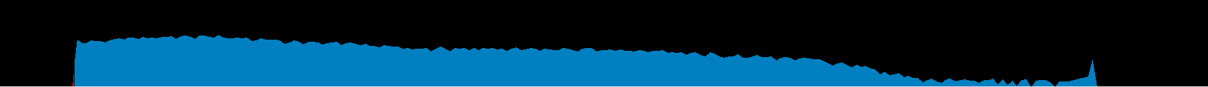

  2. It becomes Red at the far right from time to time, even with default settings on Contrast and Brightness.
  3. You don't want the video to extend into the red at either end. At least, not much.
  4. Okey, itīs always red and still at the left side, though the right side got fixed with lowering the contrast, tried playing some things, and seems well, will play around with it if i am not satisfied later.
  5. The image in the link I posted has too much in the red. I did that on purpose just so the image would show some read.
  6. Well itīs like this, the red on the left is always there (or atleast very much from what i saw).
    Itīs pretty much standing still to.

  7. That small amount in the red is ok. It's really just noise in black areas that's going below IRE 0 (Y=16).

    There's usually a black border somewhere in the frame on incoming video. Black borders (usually around RGB 0) will always be in the red. They look like a small left-hand "spike" that seems to be all by itself. On most histograms, darks are to the left, brights to the right. You can temporarily eliminate black borders from view by using the Crop menu - but don't forget to undo any cropping before you capture (I can't tell you how many times I forgot to do undo the cropping and had to run the damn thing all over again).
    Depending on the recording or player, there might also be some bright border noise or signal noise along one or more edges that will throw off your histogram.
    It's best to capture the entire image, but turn your border cropping off during capture. Borders can always be fixed after capture. For most post-processing filters, you need the whole frame. Many filters and processing apps will choke on cropped, non-standard frame sizes.

    In my experience the black borders are usually at IRE 0 (y=16, RGB=0 after VirtualDub's rec.601 conversion), the same black level that the rest of the picture should have. Of course, many recordings have the wrong black level so you may have to let the black borders fall below IRE 0 in order to get decent contrast in the main picture.

    Like Sanlyn said, crop the borders and check the histogram. Another way is to play a video (and leave it playing) before you start VirtualDub (so VirtualDub doesn't use video overlay) then use CSamp to check the preview in VirtualDub. You want the darkest parts of the picture to be around RGB=0.
    If your capture device's proc amp doesn't have the range to let you fix it while capturing you can fix it later while editing/encoding.
