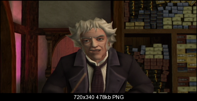

  15. Okay, i have now finally gotten an s-video cable for my Xbox, and the quality is as expected except for, a noise thing, i donīt really know what it is.
    So posting a picture, look at the background, there is like a net or something, thanks

  19. It still looksl ike dot crawl artifacts -- but they're blurry? Can you upload a losslessly compressed YUY2 video sample?
    Try DeCrawl() in AviSynth. Or Dot Crawl Comb filter in VirtualDub.

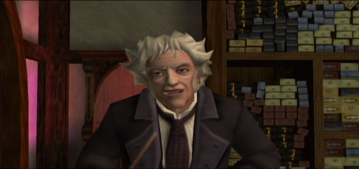

  21. Yes, Dot Crawl Comb Filter in VirtualDub works. DeCrawl() doesn't completely remove it. But CheckMate() does a good job. CheckMate() at default settings:

  22. But i donīt get what you mean with Dot Crawl, as the dots that was hanging around every color is gone, the only thing now is the X of red and green;S
    Saw that it removed that;O
    But is that even dot crawl?
    isnīt it some sort of, bad handling of luminance and chroma?
  23. Dot crawl is caused by leakage of the chroma signals into the luma channel, and vice versa. It usually shows up at edges but can show up anywhere there is color, depending on how well it's filtered out.

  25. Originally Posted by zerowalker View Post
    So what you see here, is it the card or the cable?
    I think it's the console's fault. The graphics chip's output is composite and they use a cheap composite to s-video splitter to produce s-video output.
