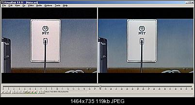

  13. Well thought it would be good to bring it up, if you look at this video you can se that there is alot of noise.
    I am encoding in X264 with Megui, so i am using Avisynth.
    What do you think is the best method to decrease the noise, but try to keep sharp edges, and is there a way to increase contrast a bit, as itīs cartoon, and it looks to "Black/White" ish

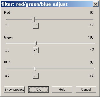

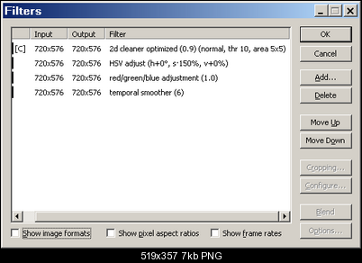

  14. First, look to see if you can adjust the capture card's video proc amp settings to adjust the picture to your liking. If not you can always filter afterwards. Your clip is too little to tell exactly what the adjustments should be but I think the black level looks about right. Maybe the white level could be higher. The saturation looks low. And obviously, it's noisy like all VHS. Here's a little quick filtering in VirtualDub:
    There are many filters in AviSynth that are similar to these. If I have time I'll give some examples of that tomorrow.
