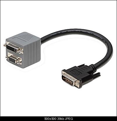

    Each DVI-I port is capable of driving two monitors, DVI-D and VGA. Further, DVI-D can be pin adapted to HDMI. In theory, one could make a DVI-I to Y cable with VGA and HDMI connectors.

    One could make an adapter like this with VGA+HDMI

    That is as good a suggestion as I could have expected to get for my initial question ( I learned something about DVI). This cable + DVI>HDMI adapter would make the right connections but I couldn't know if/how the GTX would drive it.
    It turns out that the cost of this cable is at minimum $25-30 and for that I found a second decent graphics card (Asus Radeon 5450 - $20) on sale at Microcenter. I got EVGA to send me a free 2nd DVI>HDMI adapter so I have the two big monitors hooked via HDMI on the GTX and the 19" via DVI on the Radeon. I get (the same) audio coming out of both HDMI cables and can set up the monitors any way I want.
