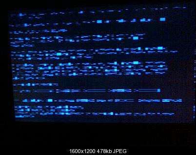

    Since I last posted I have found more problems with other video encoding programs. With Nero Vision Express, after I add a video and get to the very last screen before burning where it plays the video, my PC crashes.
    With ConvertXtoDVD, as soon as I open the program, my PC crashes.
    Here is the screen that comes up after the crash.
    Mar 2004
    Long Island NY
    i solved this issue by installing a graphics card and not using the onboard graphics in case anyone else runs into this problem.
