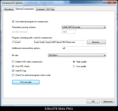

  11. To the EAC-Users: Are my settings OK? I think that I stay with EAC.
    Everything works fine.
    The "bugs" I mentioned are:
    - the "ACCESS VIOLATION"-notification which appears when I click on play and then on stop (appears only sometimes and when it appears I have to close and restart EAC, then everything should work fine, if not, I close and restart EAC again)
    - the text of the Accuraterip-window is broad, so the text is not fully readable (can be compared with dbpoweramps accuraterip-window, which is not broad and OK) (can anybody tell the author of EAC this? - thanks)
  12. nobody an idea, if this is 100% correct for highest quality *.mp3-files?
  13. Haven't updated my EAC in years, don't know if things have changed much. This is what I use in additional command line options:
    %l--alt-preset 160%l%h -m s -v --vbr-new -V 0 -b 32 -F%h %s %d
    The stuff between the %l's applies to the low quality setting, the %h's the high quality. With your LAME version the commands are a little different. In high quality, I use VBR to save a little space. The -V0 setting is the best quality with a target of 245 kbps; that doesn't mean a maximum of 245, many frames will still hit 320. The -b 32 -F sets a minimum bitrate of 32 kbps, some players need that. Your current setting of -q0 is used for CBR encoding. The %s %d are used with EAC to add the ID3 tag. Even if you don't want to set low/high commands, you should add -m s to have LAME encode in stereo instead of joint stereo.
    Check out the Hydrogenaudio EAC configuration wiki. Also, here's the complete LAME command list.
