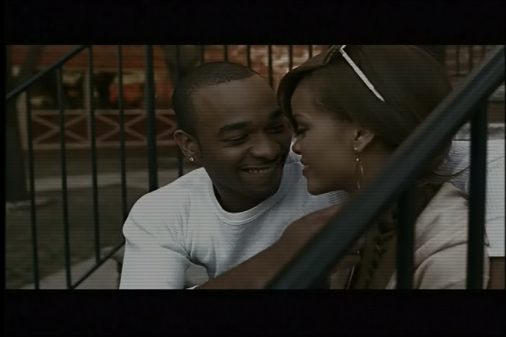

    I'm gonna IVTC a telecined video.This is what I get after tfm(slow=2,clip2=nnedi3).
    As can be seen from these shots, there are some artifacts that the built-in deinterlacer of tfm simply can't deal with. Are there any ways to get rid of those nasty artifacts

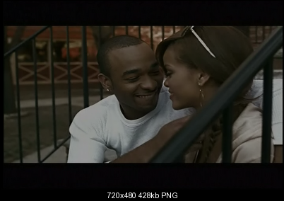

  10. Originally Posted by drawar View Post
    Do you want a longer sample clip or the whole video (4m 54s /269 MB)?
    No, I mean the IVTC has too few frames to work with between the black sections. Regarding the fade-after-pulldown problem, look at frames 46 and 47 of the sample. A perfect IVTC requires that one field come from each of those frames. But the frame 47 has been faded. So the matching field is darker than the matching field from the previous frame:
    That means TFM doesn't recognize that the two fields match. It sees that as a very interlaced frame.
