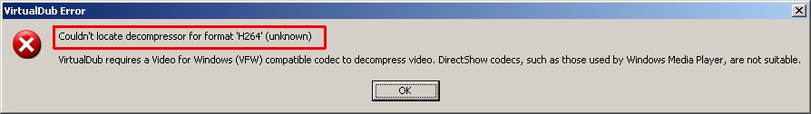

  1. VirtualDub gives this error when I try to play certain AVI files.
    GSpot says the files is:
    Video Codec Type: H264
    Video Codec Name: H.264/MPEG-4 AVC
    Video Codec Status: Codec(s) are Installed
    I can play the file with all the other players I've tried.
    It's obviously a by product of uninstalling ffdshow. I don't want to re-install that for now at least (mainly because I find it impenetrably complex!). I have AVIs associated with VirtualDub, so how can I get it to play files of this sort please?
    I'm also puzzled why MediaInfo seems to be reporting the file rather differently:
    Format : AVC
    Format/Info: Advanced Video Codec
    Format profile: Main@L4.0
    Codec ID: H264
    Codecs remain a true black art to me, so I'd much appreciate some help please.
    Terry, East Grinstead, UK
