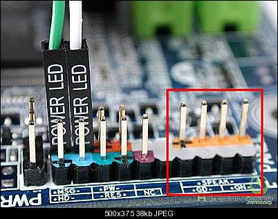

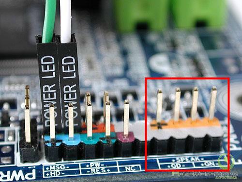

  11. This page has a picture of the typical speaker connector on a motherboard:
    http://au.hardwarezone.com/reviews/view.php?cid=19&id=1215&pg=21
    Your motherboard must have one of those to connect a speaker. I've seen a few motherboards with only 2 pin connectors for the speaker.

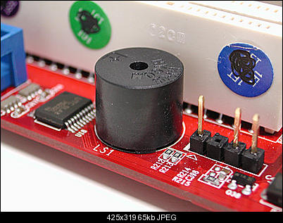

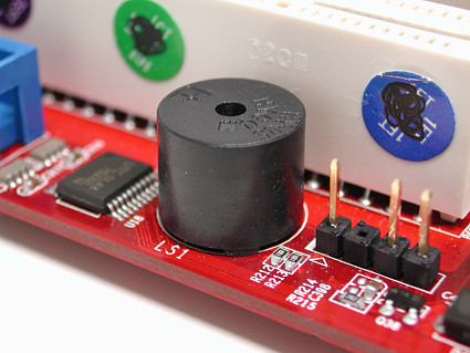

    Here is a motherboard with an integrated piezoelectric speaker:
    Note there are two ways a DOS program can address the onboard speaker: by using BIOS function calls or by writing directly to the speaker hardware. When using BIOS calls a sound card driver can intercept those calls and produce the sounds through the sound card and the external speakers. Writing directly to the hardware can't really be intercepted (well, it can but it takes much more sophisticated software that nobody supplies).
    I've also seen a few sound cards which let you connect a cable from the motherboard speaker header to the sound card. With those you got the motherboard beeps through the sound card and its speakers.
