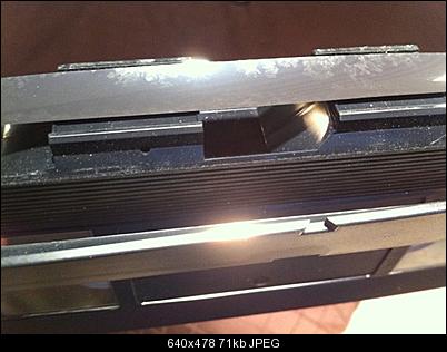

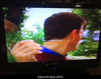

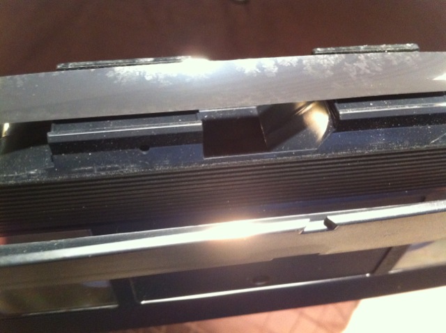

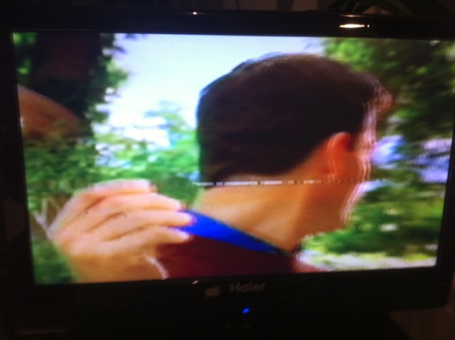

    I've attached a picture. This is a minor example, as certain spots have numerous lines scrolling through the image.
    Anyone know how I can fix this? Since I've noticed it on different vcr's, I'm sure it is a tape problem.
    Thanks.Click image for larger version

    Mold.

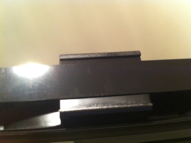

  5. Can this be removed or fixed? What is the best method to deal with this so that the tapes will play "normally" again?
    The tapes must be specially baked and cleaned.
    This is not something a home user can do. I can't even do it with a small studio.
