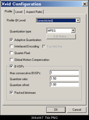

    I have a question regarding the Video Compression profile for Xvid. Even though I am recording an analog Standard Definition source, I chose Xvid HD 1080 profile because I assumed that would give me the best video quality. Am I right in assuming that or is there something better?
    The profiles don't do much of anything in Target Quantizer mode. Once you get beyond the first few "Simple..." profiles they don't do anything. If you go to the detailed Profiles dialog you'll see what options they change:
    Be sure you're using the "Interlaced Encoding" option since what you're capturing is interlaced video. Be aware that many players don't play interlaced Xvid very well.
