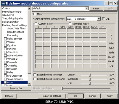

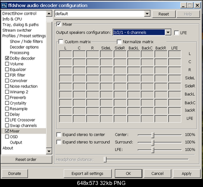

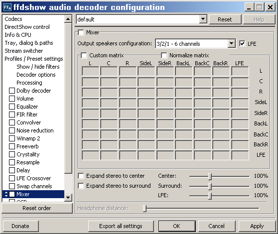

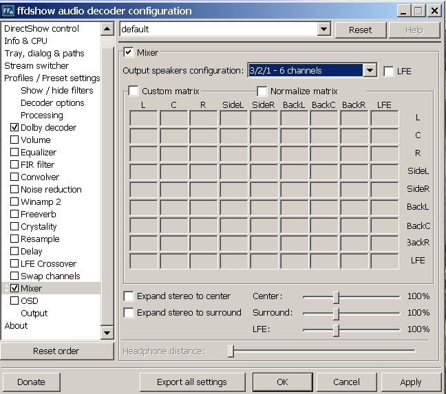

  19. I have been llookig at the ffdshow configuration panels. Can't see any place related to enabling 5.1 surround sound. I am lost. Is the ffshow mixer the place to set 5.1?
  20. Look at the Mixer controls. It will automatically decode to multichannel unless you have the mixer set to downmix.
  21. Originally Posted by shaunthesheep View Post
    follow the instructions posted above about graphstudio
    it's for determining what your directshow setup configuration
    (you might not even be using ffdshow for audio)

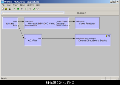

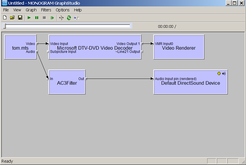

  22. Thanks, I have downloaded Graphstudio. Here is the grah for my 5.1 mts file.
Name:	graph edit mts 5.1.png
    Interestingly, the mp4 file with aac created via FFmbc, which also retains 6 channel audio in the converted file, imports into Lightworks OK and the audio is not down-mixed.
    I tried the higher audio bitrate (256k) and there is a quality improvement except for one section where a speaker exclaims in a much louder voice than elsewhere. The voice is is not clear--slightly
    "muddy".
    In the avi file saved in Vdub. voices sound like they have been slowed from 45rpm to 33 rpm--very deep bass.

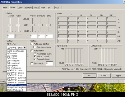

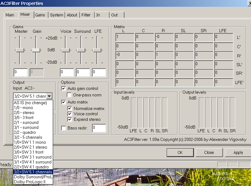

  23. GraphStudio shows that ffdshow is not being used to decode the AC3 audio. AC3 Filter is being used -- and that's probably configured to downmix to stereo. Right click on AC3Filter in GraphStudio and select Properties to change its settings.
  24. I just changed the channels in the AC3 filter properties to 3/2+SW 5.1 channels. See screen grab. I imported the MTS and it crashed Vdub. Have I got the right selection? Is the AC3 filter the same thing as the AC3 plugin? I also installed yesterday the ac3acm fix 2 codec. Just trying to figure out where the AC3 filter came from.
    EDIT
    Tried again to import the MTS into Vdub and it successfully saved a 5.1 audio AVI that imports into Lightworks and plays OK with all 6 channels intact. Only slight problem is some background noise in the audio playback in Lightworks. A sort of faint but noticeable crickets-like sound. This sound is not present when playing the converted file in Media Player Classic Home Cinema. It could be my active Roland studio speakers which are attached to the soundcard (via a mixer)--they do pick up noise. However, the crickets sound is not present in a file exported from Lightworks. Video and audio is excellent. Lightworks manages to down-mix to stereo in the exported file. Can't see an export option to prevent this. I will ask about this in the Lightworks forum. Many thanks for your assistance.
