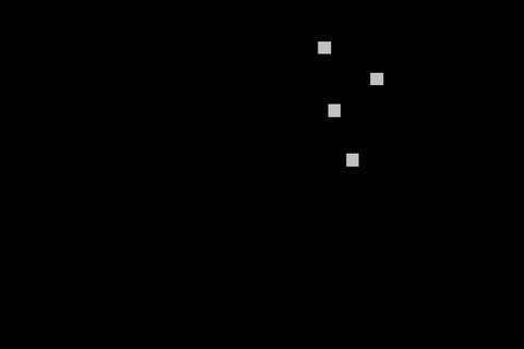

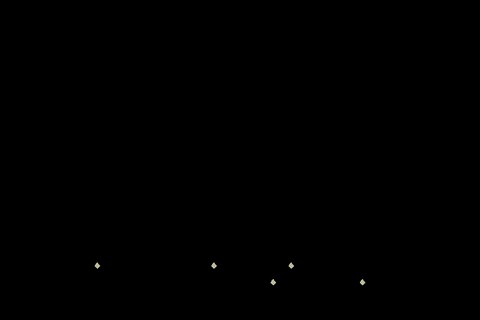

  9. Like I said, my suggestion is to just add in the audio and use the remote control to access it.
    I don't think you understand what the subpic is. It's not the picture you've already showed us. You open the menu VOB in DVDSubEdit, scroll to the menu whose subpic you want to edit, and then 'save currect subpic as bitmap'. If it's a 16:9 menu, you'll have to save out both the 4:3 and the 16:9 versions. After editing it you stick it back into the menu using 'replace current subpic with BMP file'.
    The actual button creation and menu command creation is done using PGCEdit. Open the DVD. Right-click the menu->Menu Buttons->Edit->Button->New Button. After you have it the shape you want and in the location you want and the adjacent buttons all set up, in that same Menu Editor screen you can set up the menu command that happens when you click on that button (It'll switch to the Portuguese audio track). Easiest will be to create an STN command. Go Alphabetically->Set STN and point to the Portuguese audio.
    Go back to the main screen, save your work, and test it out in a software DVD player before burning to disc. Then, after burning test it thoroughly in a standalone player. Again, this isn't the easiest thing to accomplish. Below I'll add a couple of smaller examples of what menu subpics might look like:
