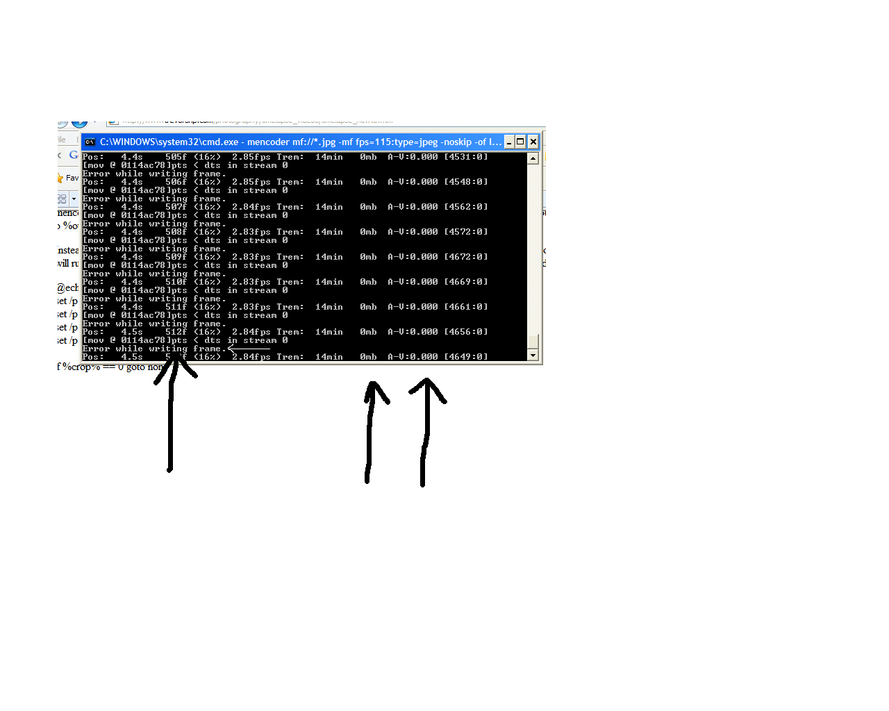

  1. I downloaded Mplayer, VLC and followed the mencoder tutorial here:
    I added the proper folders to the path variable, as instructed, and used the following code in a dos shell in the folder that stores the jpg image files.
    mencoder mf://*.jpg -mf fps=115:type=jpeg -noskip -of lavf -lavfopts format=mov -ovc lavc -lavcopts vglobal=1:coder=0:vcodec=libx264:vbitrate=5000 -vf scale=1280:-2 -o test.mov
    It goes through all the images in the folder (around 700mb of jpg), but it doesnīt seem to add any frames to the video, it says "error while writing frame".
    The resulting video file is only 1kb. I've attached a screenshot that demonstrates the feedback I get. As can be seen, no images are being added to a video file( size is 0mb and the length of the video is 0)

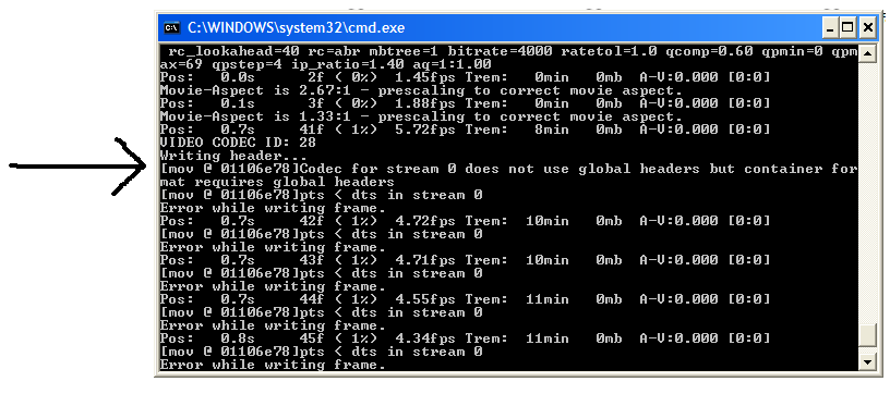

  7. I tried to work further with mencoder/MPlayer, but I have a feeling that this is a codec problem, maybe some codecs are missing.
    Using the command
    mencoder mf://*.jpg -mf fps=60:type=jpeg -noskip -of lavf -lavfopts format=mov -ovc lavc -lavcopts vglobal=1:coder=0:vcodec=libx264:vbitrate=4000 -vf scale=1280:-2 -o testvid.mov
    I get the "error" when writing header
    "Codec for stream 0 does not use global headers but containers for mat requieres global headers."
  8. I found out what the problem was. I was simply missing the libx264 codecs. This worked when using other codecs from the libavcodec library. How should I install libx264 so that I can use it with mencoder? Is there a better codec that I should use that compresses the images.
