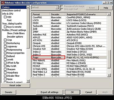

    However, several threads I found during my research implicated ffdshow. I do have that obscure program installed and I have over the years made settings with it (but not for ages). Looking at it now I find it almost totally impenetrable! I wouldn't know how to begin explaining what it does or why it's configured the way it is, or which changes I made myself. However I opened 'ffdshow video decoder' and in the list of codecs I found the one for FRAPS. I changed 'disabled' to 'libavcodec' as shown here:

    After some use of Refresh Thumbnails, the AVIs are now displaying correctly. But why? And what possible negative consequences might now arise?
    Any simple insights into how ffdshow works and how to configure it would be much appreciated please.
