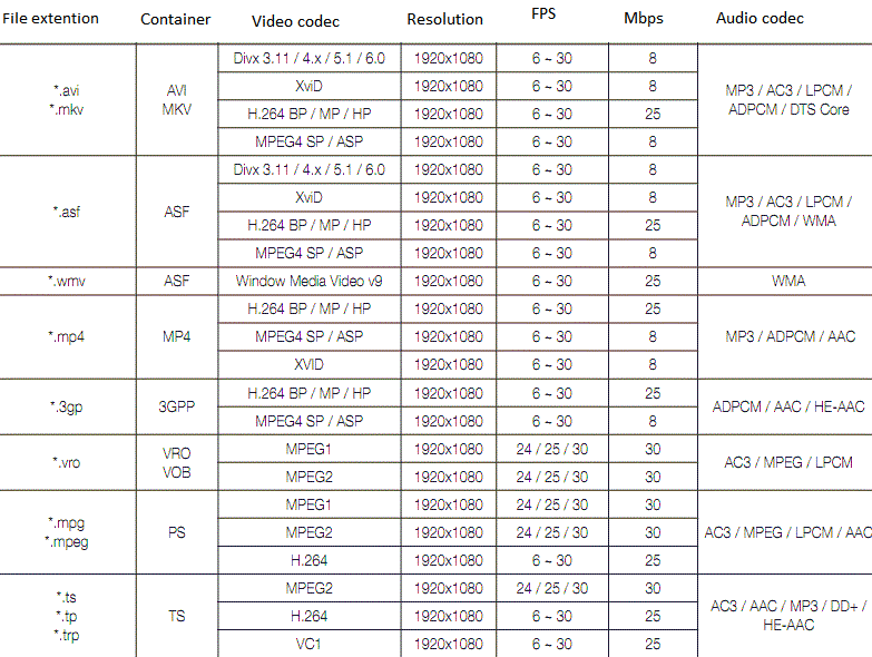

    How about posting the specs on what the TV accepts?
    Jan 2008
    Netherlands
ID:	6974 These are the accepted things of my tv.
  10. The lesson here is that the message is not always accurate, or sufficiently precise.
    Second thing here is that this message is not coming from a TV at all, it is coming from a playback device. Some information on the device that is actually decoding the file, as opposed to the one merely displaying it, might be helpful. Also is this file on disk, USB, network, what?
    The codec was intended and is also indicated to be the same. Therefore, that is not the problem. Two significant differences have been pointed out, I know of some strange things happening with similar height numbers so personally I would start there. Take the "bad" flick, cut out a small piece, resize it to the same as the "good" one, test.
    The message should probably be "codec not supported, At That Resolution." But that would be too easy.

    The message "codec not supported" is coming from the tv if thats what you mean.The specs you see on the .gif image are the specs my tv can handle.Not a playback device.Not a media player or so.
    And the file that doesn't get accepted by the tv is on a 2.5" hard disk.
    Both movies are.
    I will try to make the movie with the same resolution as the other one and see what happens.
    If thats the problem it would be strange.Strange that the tv says "codec not supported" just because of the resolution.
