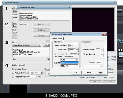

    I use a KWORLD 2800D USB 2.0 capture device.
    http://uk.kworld-global.com/main/prod_in.aspx?mnuid=1335&modid=12&fcid=8&pcid=236&ifid...243&prodid=104
    it can capture up to PAL: 720 x 576 @ 25 FPS
    As you can see from the screen the capture stream option only allows me one selection (the YUY2). It only allows this regardless of the codecs I install, or capture software. I think it must be a limitation of the usb dongle. I would like to be able to try other compression codecs for capture. As I say I may need new hardware.
    Cheers.

  8. Originally Posted by lordsmurf View Post
    You need better hardware.
    (Not necessarily something "new" -- just better.)
    Thats what i meant
  9. YUY2 is about as close to analog video as you can get from a capture card. Uncompressed 720x576 YUY2 is probably too much for your hard drive. HuffYUV is a good choice of compression codecs because it is lossless (the YUY2 output from HuffYUV is exactly the same as the YUY2 that went in), fast enough for even modest processors, and compresses enough that disk I/O won't become a bottleneck. After capturing you'll probably want to filter and convert to a more compressed format like MPEG 2 for DVD.
    But capturing with VirtualDub won't get you better quality than your current software unless there is some problem with that software (dropping frames, etc.). VirtualDub may give you a little more control over some of the capture device -- like the video proc amp, noise reduction filters, etc.
    You're looking in the wrong place. What you posted a screenshot of is one of the hardware's own DirectShow pages. You want to be looking for your installed codecs in the software's menus.

    Hi there,
    Thats my point - there is no where else to change the input video stream codec. Thats the only box that is there, and you can only pick YUY2. As I mentioned I think i need some new better hardware.
    Thanks.
  12. Originally Posted by VHSMadness View Post
    Try capturing with VirtualDub.
