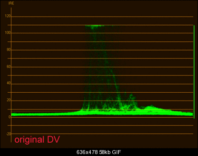

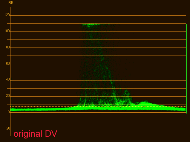

  18. Member
    May 2009
    I was all set to show the differences I am seeing but it looks like folks have already noticed them. I'll post this little image anyway since I went through the trouble.
    It does look a lot like what you get with an RGB conversion, and that's why this is bugging me. Why go through all this trouble if a RGB-conversion-like amount of degradation is taking place anyway? Well whatever it is - and I note that there's no clear answer here - it's not the same thing you get with a definite RGB conversion. The differences from the original are similar but distinctly different from one another. I also don't think it has to do with 10-bit vs 8-bit because if you export as v210 and also as UYVY and compare the two, the two results are in fact identical.
  19. Originally Posted by Asterra View Post
    I don't think so. Values would be clipped >100IRE if a Rec601/709 RGB conversion was done, but 100-110 still exists
    It still could be 4:2:2 vs. 4:1:1 for DV. Both v210 and UYVY are upsampled to 4:2:2, but I don't know why the luminace would be different; I thought Y should be independent of Cb,Cr
