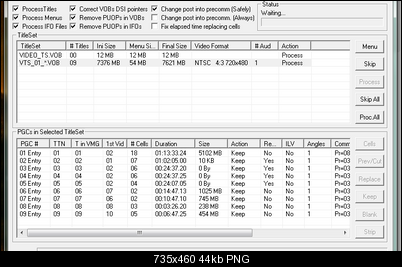

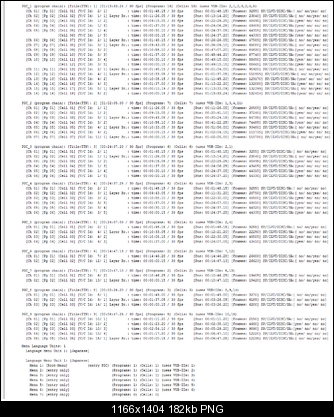

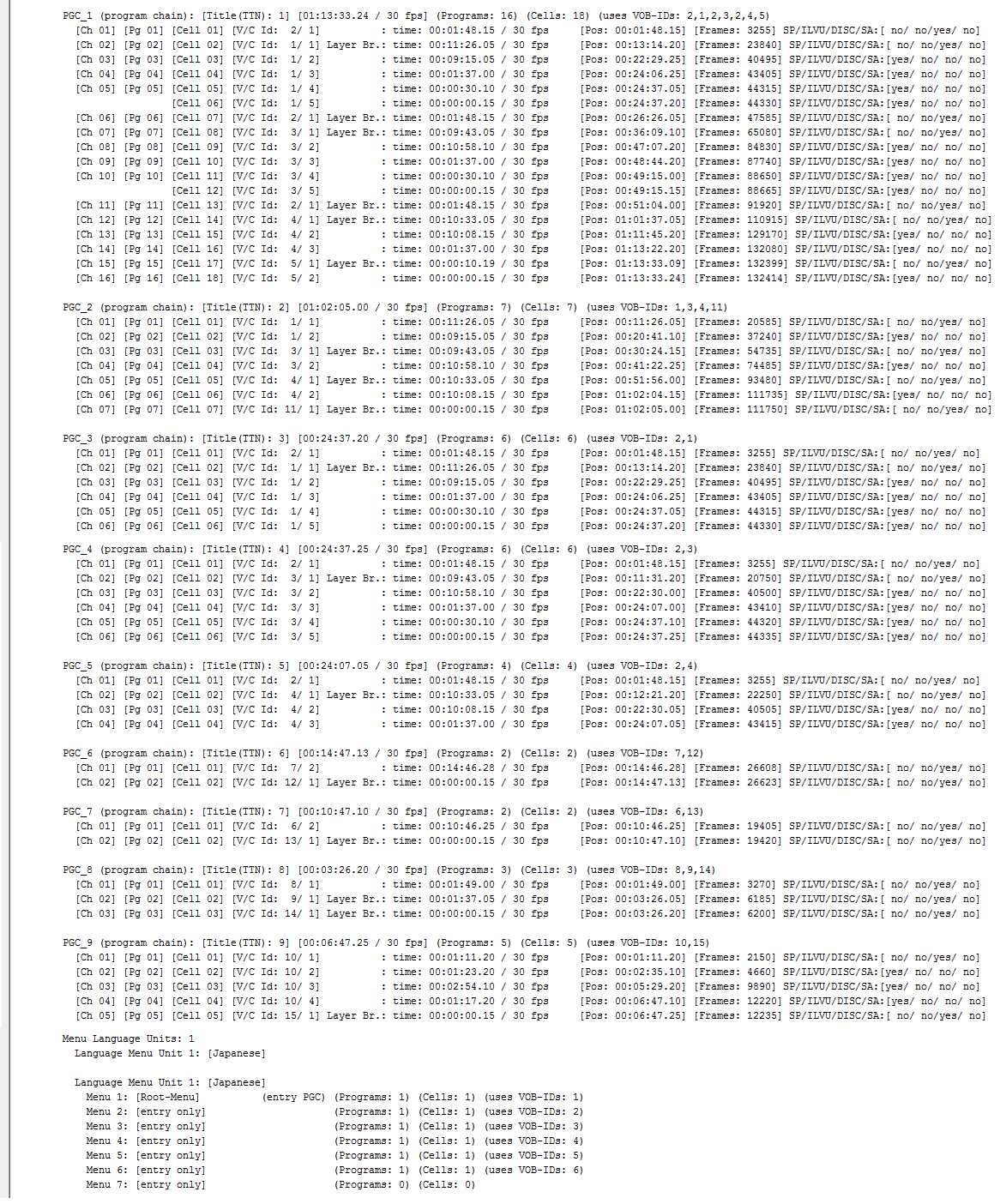

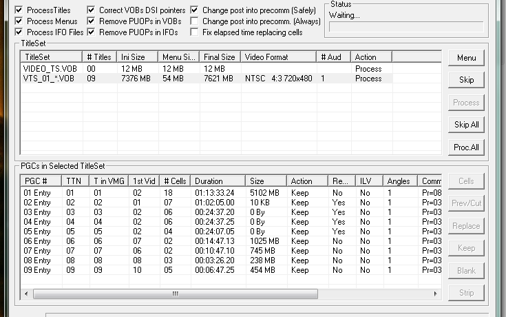

  5. Thanks for your response, I'll try out what you told me and let you know.
    In the meantime I thought maybe these two pictures might hopefully shed some light.
  6. You have to demux 5 different titles and create subs for 5 different titles, numbers 1, 6, 7, 8, and 9. I interpreted what you wrote to say you were trying to do the whole thing once, work on the entire VTS at once. And, of course, you can't do it that way. Maybe I just misread you. You don't demux the VOBs all at once, the way you tried to do using ReJig. You take each title, one at a time, and demux it to its own folder using PGCDemux. Then after adding in the subs and creating a bunch of little DVDs with Muxman, you replace each of the titles (ignoring numbers 2, 3, 4, and 5) separately in VobBlanker.
    I should probably also mention that I tried demuxing the VOBs with ReJig (I tried demuxing the VTS_01_0.IFO with many programs) using file mode and that seems to be the only may for me to get an m2v and ac3 file that includes the main episodes and all the extras
    Nope. Use the drop down box in PGCDemux to locate and demux the extras. Both guides to which you linked above are old and obsolete. Baldrick's guide is the most up-to-date. Follow his method 2.

    The structure is different when I demux by VobID. There are 15 vobid files as opposed to those 9 Pgc's I mentioned, and I don't even know where to begin on how to inject them into the original ifo with VobBlanker, let alone what to do with the multiple celltimes files.
    Fortunately I got it to work by following your instructions and Baldrick's guide, and, demuxing by Single Cells instead, muxing separate dvds, then using VobBlanker to replace cells and it worked.
