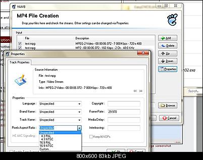

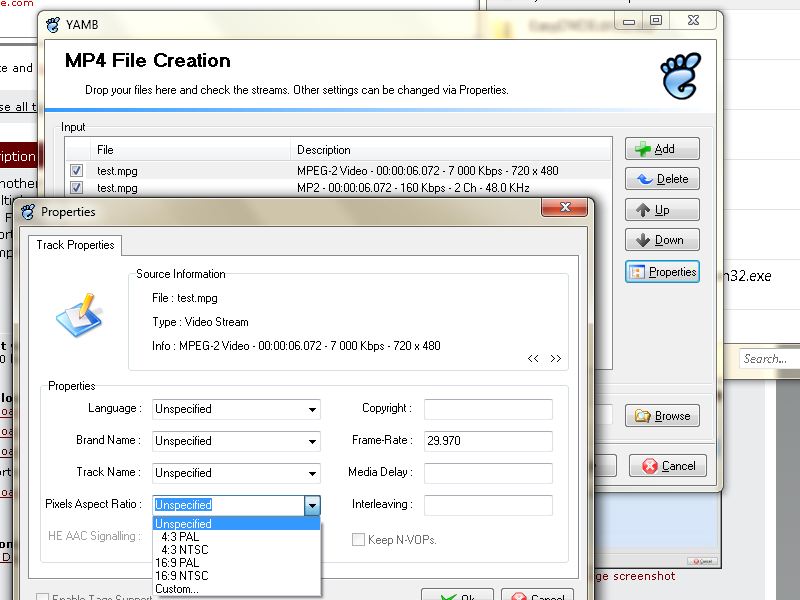

    It's in the gui, in yamb 2 after you selected create an mp4 and on the video track and then properties,
  4. Aha. I had YAMB 1.6, not 2. I'll report back...
    Hmm, not good. After inputting Pixel Aspect Ratio as 4:3 PAL, I checked the old and new files with MedioInfo - the Display Aspect Ratio of the original is 16:9 but for the YAMB conversion MedioInfo says 1.939. And on my TV, the new file still gives a 'wrong' picture plus there are white lines along the top that aren't in the original.
