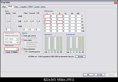

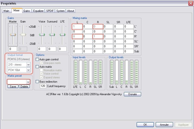

    These are my settings for AC3Filter :
    Main Tab :
    Only "Preset" is concerned.
    Mixer Tab :
    "Gains" all 0 (null)
    "Options" all unticked
    1) Output format : 2/0 - stereo and PCM 16bit
    2) Matrix :
    Input channels are L, R, C, SL, SR, Sub and LFE (Left, Right, Center, etc.)
    Output channels are L', R', etc.
    3) Matrix preset
    Our wish is to select the channel(s) we want to hear. How it works ?
    Enter a number assuming 0 is for null output and 1 for 100% (negative value are possible for some reasons like removing common sounds or accentuating difference).
    Our wish is the following I want to hear in the X' output channel the X input channel from source.
    L'=L=1 AND R'=R=1 OTHERS=0 (null) ->Save as "NORMAL" in "Matrix preset" AND "Main Tab->Preset"
    For VCD Karaoke I want LEFT channel
    L'=L=1 AND R'=L=1 OTHERS=0 (null) ->Save as "LEFT" in "Matrix preset" AND "Main Tab->Preset"
    For VCD Karaoke I want RIGHT channel
    L'=R=1 AND R'=R=1 OTHERS=0 (null) ->Save as "RIGHT" in "Matrix preset" AND "Main Tab->Preset"
    To switch between presets, play you VCD with MPC and go to the AC3Filter notification Tray and Right-Click on "LEFT" or "RIGHT" or "NORMAL" to hear want happens.
