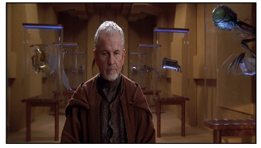

    http://img6.imagebanana.com/img/lhn68cvn/bla.jpg (The black frame is supposed to be frame of your TV.)
    If that's really what you're looking for, the crop option in ffdshow is in fact probably the best way to do so.

  7. The image that was posted is a great help. I really do hate the black bars. The bottom image is what I'm stuck with when I tinker with the Resize and Aspect Ratio settings in FFDShow. The second image is what I don't like and the third image is most appealing. How much am I really losing?
    Seems like this image is provided by a software developer to demonstrate how their software can squeeze the full picture (2:35) into a 16:9 display. Is that the case?

  9. Originally Posted by manicjonah View Post
    With the version on the third image, you're losing about 27% of the whole image (If, like in this example, the movie aspect ratio is 2.4). So that's the question you've gotta ask yourself: What's worse? Black bars (no loss of information, but might be annoying), cutting off the edges (and losing lots of information), or a completely wrong aspect ratio (everything appears way too narrow)?

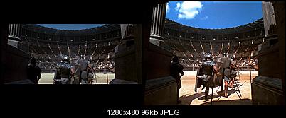

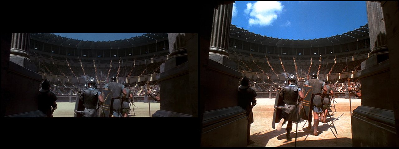

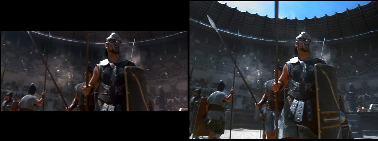

    Take a look at the images towards the bottom of this page:
    http://www.dvdbeaver.com/film/DVDCompare7/gladiator.htm
    particularly the third image in each comparison (labelled as HDTV).
    I have to admit, I'm not a purist. If the frame can be expanded vertically to fit a 16:9 (or 4:3 TV) and give the film more impact, then I'd often go for that option. For example, I wonder if it's possible for a Bluray disk to have a 16:9 full height version of a film, with the option of overlaying black bars at the top and bottom for people that want to see it as it was in the cinema. This wouldn't be possible for anamorphic (eg Panavision) movies, though.

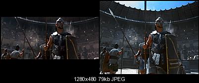

    A couple of examples:
    left - intended theatrical 2.39:1 version, right - most/all of the S35 frame (taken from a trailer on the R2 Gladiator DVD):
