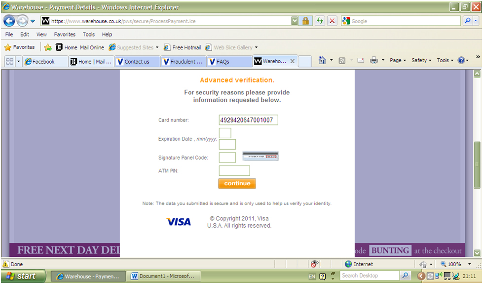

    My wife seems to be having difficulties with ordering stuff on her laptop.
    When she places an order for an item she is taken to the shown in the attached image.
    The websites she has this happened on are www.warehouse.com www.pet-supermarket.co.uk and www.petersofkensington.com.au
    I have tried using AVG to scan for viruses and also malwarebytes anti-malware but nothing came up. My wife sent an email to Visa and they were very negative and said they could not deal with it.
    Any ideas what this could be as it getting annoying that she has to use my laptop to order stuff online.

    Denvers dawgs: maybe but asking for her ATM number?! Thats dodgy to me!

    ahh yes... that one slipped by me. That does seem fishy

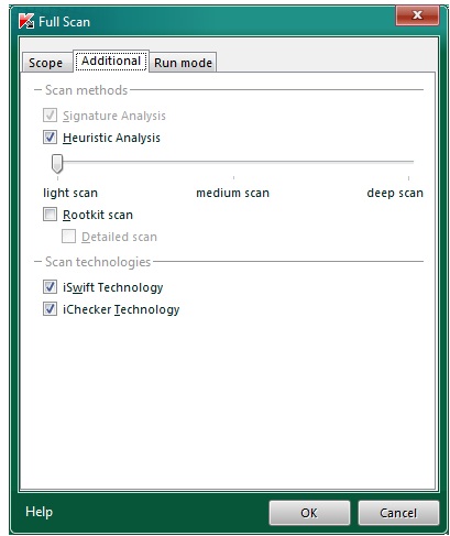

  16. That's a rogue site dont enter any personal info on there, you should buy a AV like Kaspersky IS since I don't put great hope in the free ones, u can try one of these tools there free: http://www.kaspersky.com/au/virus-removal-tools (Kaspersky Virus Removal Tool is a utility designed to remove all types of infections from your computer.)
    or install the trial of kaspersky get it to do a full scan and change settings under flll scan to include rootkit scan,m you can also change the scanning level from light to deep scan just look and try to understand wehich settings you need it's highly customizable.

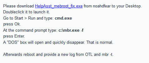

    i can't post the instructions to help removal as i have them as the link is not working. but find the "helper" program with a search and use these steps.
