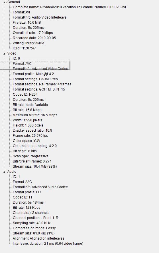

    I don't know what any of this means. Does this help?

    Not sure why I'm not seeing your MediaInfo attachment correctly, but looking at it from edit, it appears to be H.264 video at 1920 X 1080 @ 29.97fps with AAC audio. Type 1 or Type 2 is more common with DV tapes, not H.264.
    Not that familiar with Premiere, so not sure if or why it wouldn't accept the video. Does it play back properly with VLC or other players that can do H.264?

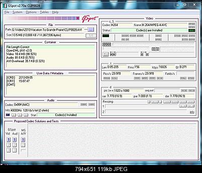

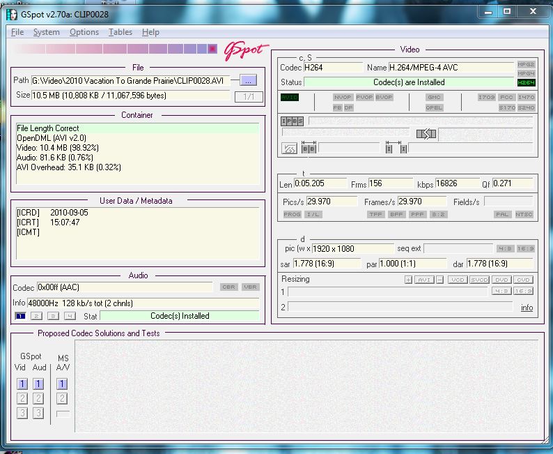

    Here is the capture using GSpot. I assume from jagabo's reply that this is a Type 2 file as it shows Audio Properties. Still can't get it to open in Premiere Pro.

  7. It's type 2 but it's very unusual for a DV AVI file to have AAC audio. I suggest you convert the audio to PCM.

    No--that may have an avi container, but look at the right column. That's 1920x1080 video, and the codec says H.264/Mpeg-4 AVC. NTSC DV-AVI is 720x480 with a DV codec.
    Screwed-up header?

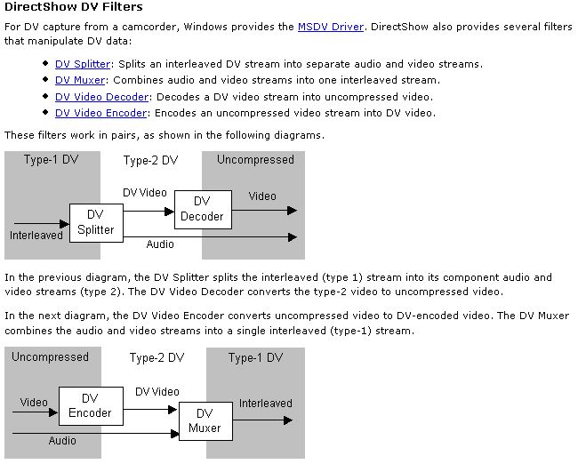

    What this diagram does not show is a typical Type2 DV-AVI camcorder file will have both interleaved and separate audio. Type 2 was invented to give editors direct access to audio without DV demux CPU overhead.

    "Type2" as Premiere (like the OP mentions), Vegas, and most other commercial NLE's refer to it DOES imply DV as the codec. But ultimately, here's the difference:
    In the RIFF headers,
    Type1 sees: "IVAS" as the stream type. This stands for "Interleaved Video-Audio Stream". That's it. One stream, already pre-muxed within the container's muxing.
    Type2 sees: "VIDS" + "AUDS" as the stream types. These clearly stand for "Video elementary Stream" and "Audio elementary Stream". Two streams, muxed within the container.
    With DV capture of Type 1, the RAW DV stream (already muxed) gets saved AS-IS without any further processing. This makes for easier/less burdensome capture, but MORE burdensome processing/editing down the road.
    With DV capture of Type 2, a neat trick is done where the RAW DV stream gets saved AS-IS - with the exception of not calling the stream header "IVAS", but instead calling it "VIDS". It also demuxes and taps off a copy of the audio, saving it to the "AUDS" stream. More burdensome to capture, but less to process/edit. Because of the way most apps read the resulting "VIDS" (nee' "IVAS") stream, the internally-muxed audio portion just gets ignored. The only other downside is the additional filesize (because of the copy of the audio stream) in type 2.
    aedipuss, what you are thinking of is the AVI "Open-DML" spec, which is a quasi spec. The original spec as defined by MS has certain limitations. Many video-computer-related industry companies realized the failings of this spec and so created the "Open-DML" spec to overcome those failings. Even though it wasn't officially MANDATED by MS, because of the strong industry support, it has become the de-facto standard for LARGER AVI files (MS now officially promotes this version, without still mandating it - but that was at the point where they developed ASF/WMV...).
    There have also been some less common/more proprietary Large-File-Overcoming variations using Segmented clips...
    "IVAS" normally only exists within DV-AVI files, so there's rarely a Type1 of any other codec. So, assume "type2" when dealing with all the other codes.
    I'm also pretty sure that the problem with the OP and the h.264 AVI file IS NOT related to either Type1 vs. Type2 or Strict/Original AVI vs. OpenDML AVI. Those are red herrings.
