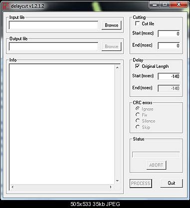

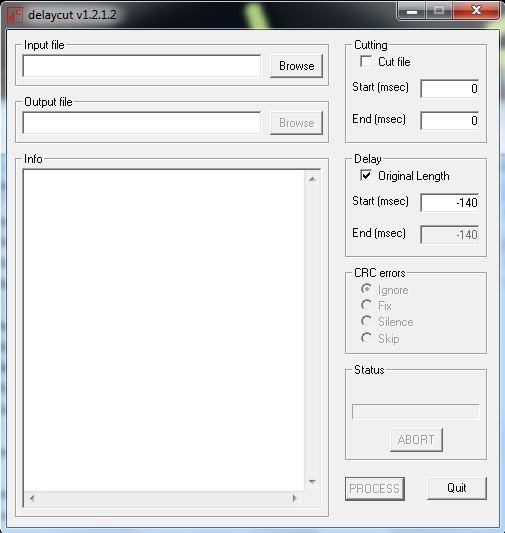

    now u can open up the app..delaycut...and take each individual ac3 file and add the exact amount of delay u need...let's say the delay is -140ms...on the right hand side of the app you'll see the "delay" section...tick the box "original length" and in the first box put..-140...if u wanna add 140 just put...140 (no +)...click on "process" and thats it

    now remux the ts the way you did it b4 and check the delay and see if they're in sync...if not, continue the same process..it's time consuming but it works like a charm...i was doing a few days ago and it did fine
