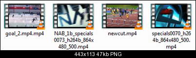

    Your Canon Ixus 220 HS records h.264 video + PCM audio in a MOV wrapper.
    For h.264 icons you may need to upgrade to Win7. Mine shows thumbnails for VLC h.264.
