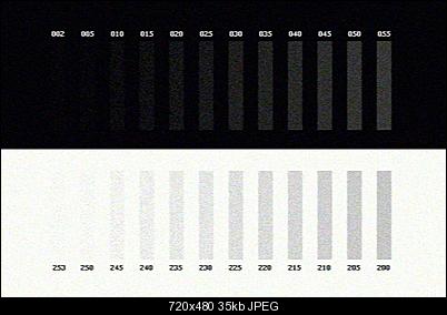

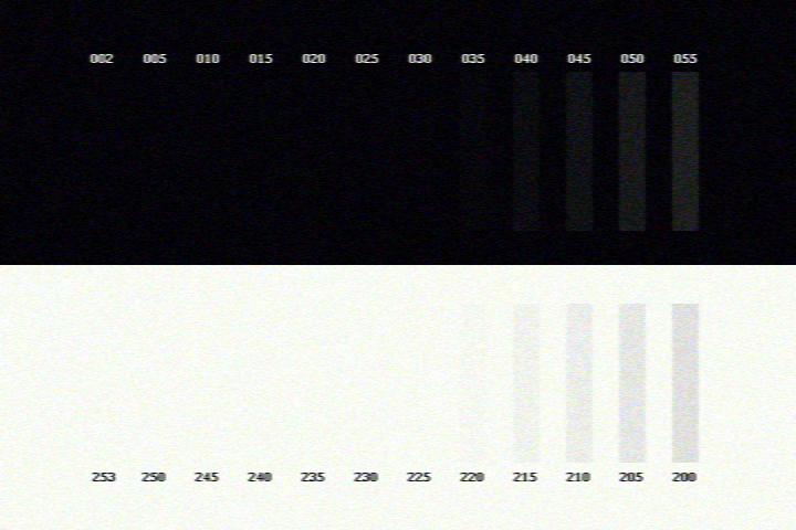

  11. Regarding the levels (all simulated images):
    Say you record this levels chart with a VHS deck:

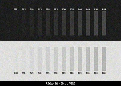

    If you capture with too much contrast, the darks are too dark, the brights are too bright:

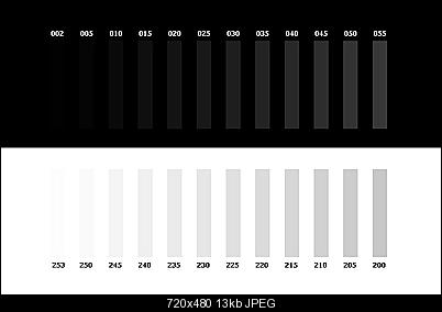

    All the darker bars are completely black and all the lighter bars are completely white.
    You can't restore any detail in those bars by filtering later on:
    Note how the bars around 50 and 55, and 200 and 205, are now restored to nearly their original brightness. But the bars from 0 to 30, and 225 to 255 are gone. There is no way of getting them back.

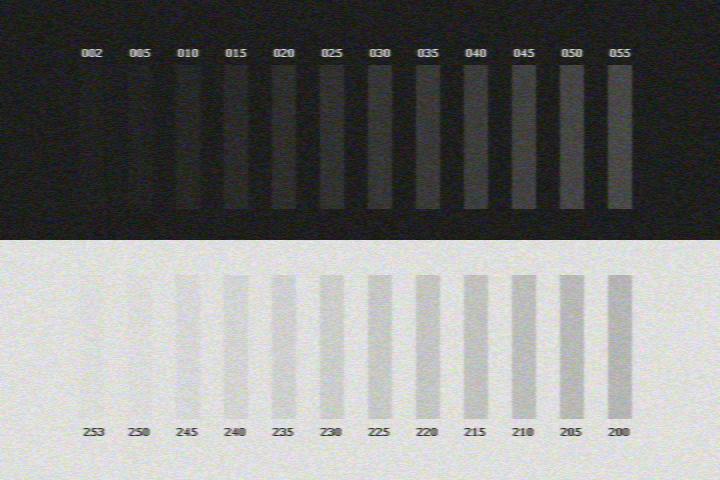

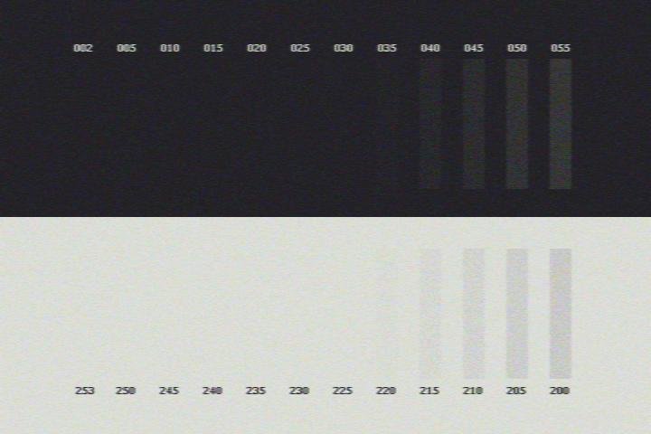

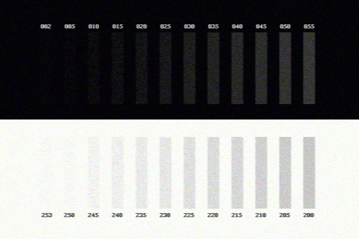

    On the other hand, if you record with too little contrast:
    Note how the blacks aren't very black and the whites aren't very bright.

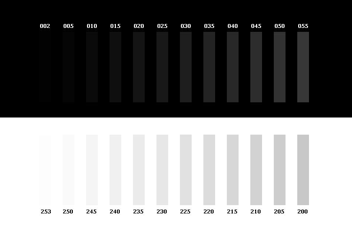

    You can stretch the contrast back out by filtering later on:
    The levels aren't exactly right, and noise is accentuated, but you can see the darker and lighter bars.
