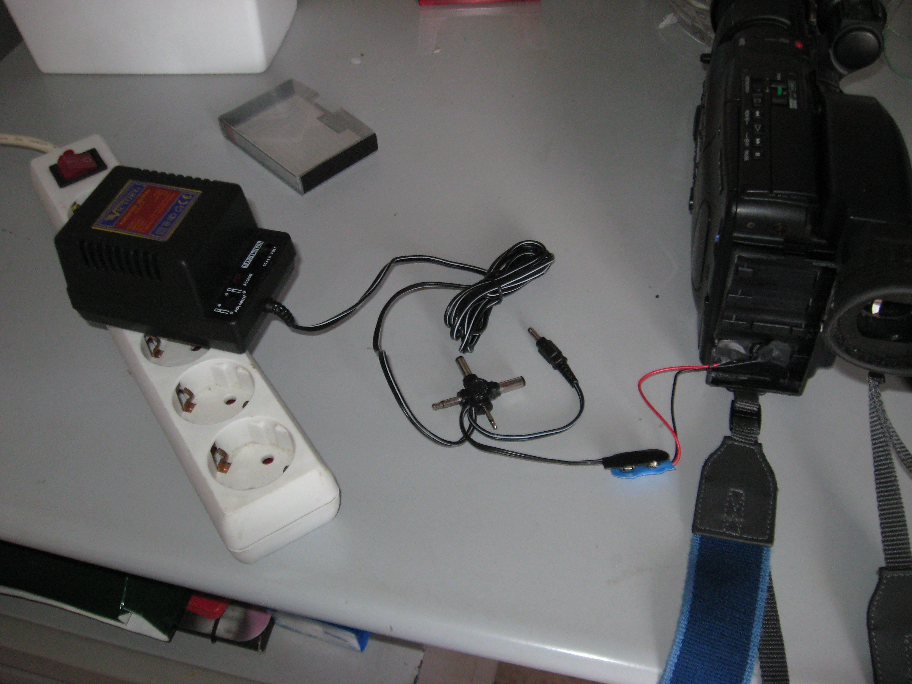

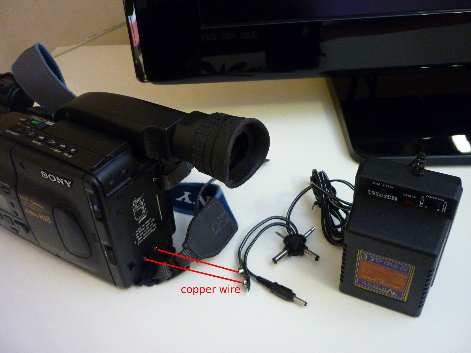

  1. My uncle lent me his old Sony Handycam (model CCD-V600E) to digitalize some Hi8 cassettes.
    The camera is supposed still working, but lacks the AC power adapter and battery charger.
    So i'm planning to use an universal power adapter with 2 wires going directly to the battery contacts:
    According to the manual the power requirements on battery mounting surface are:
    6.0V (battery pack)
    7.5V (AC power adaptor)
    9.0V (alkaline batteries)
    power consumption: 6.9W (in recording mode)
    For the voltage i guess i should go with 7.5V.
    Now the problem is the amperage:
    i have 2 universal power adapters, with 500mA and 1A output.
    According to my calculations (6.9 < 7.5*1 ) the 1A one should supply enough power.
    Am i correct?
  2. Wow, i've done it and it works!
    @6V the camera turns on, but all functions are not working.
    @7.5V the camera turns on, cassette ejects and playback starts!
    Is there any risk powering the camera this way?

  4. The manual doesn't mention the mA requirements,
    but the watts:
    6.9W < 7.5V*1A
    So i'm a bit over the requested power, i hope this won't be a problem...

  6. I've tried acquiring some cassettes, but the playback stops after a few minutes.
    Also sometimes the camera is unrensponsive to commands and powers off.
    I think i'm giving up, i don't wanna risk breaking my old tapes...
