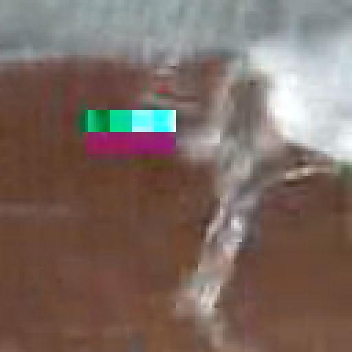

  4. Originally Posted by noiz View Post
    I've seen a guideline (LINK) containing a filter.
    I don't think that's going to help you. That is for removing blocky artifacts caused by over compression. Those types of blocks are not common in DV video. You probably have errors in the DV stream which result in a very different kind of problem (typically multi-colored blocks).
    This image contains both DV stream error blocks (bright green/blue/red blocks) and overcompression block artifacts (4x nearest neighbor enlargement for clarity):
    This is what MSU Smart Deblocking does with that video:
    Notice that the overcompression blocks have mostly smoothed out. But there is little change in the DV error blocks.
    Fixing the DV error blocks will require something like the RemoveDirtMC filter in AviSynth.

  6. DV is very high bitrate. It very rarely has noticeable macroblocking. If he has a DV AVI file that has a lot of macroblocking something is wrong with the transfer he got. Maybe they recorded the camera output on a DVD recorder and then converted the MPG data to DV. Or maybe the source (satellite broadcast?) that was recorded on the DV camcorder already had a lot of macroblocks.
    MSU Smart Deblocking requires that the blocks be on 8 pixel boundaries.
    Neat Video is a great noise filter but it won't help at all with macroblocking.

    Those are data glitches, for whatever reason.
