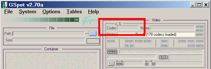

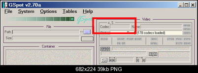

  8. Originally Posted by snafubaby View Post
    I tried Gspot. It says that the codec is apple quicktime.
    What does it say for the fourcc?
    And what does it say about the container? I suspect it's not an AVI file.

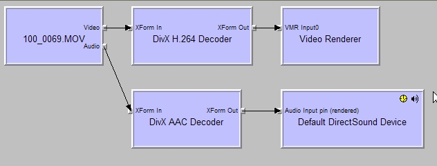

    Mar 2008
    Open the video with Graph Studio. ("render media file" from the File menu).
    Do you get a graph, and does it play ?
  15. Note that your problem is that you need ONE codec, nothing ever tells you to install a PACK of codecs, you have done that TWICE, and you still need ONE codec, yet you insist on installing a PACK of codecs, and join the LEGIONS of people who needed ONE codec, installed a PACK of codecs, failed to solve their problem, and often create multiple additional problems.
    May 2007
    This is what it looks like when rendering the media file. When i click the green arrow at the top, it starts playing.
