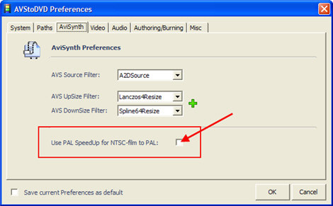

  8. I think avstodvd will use PAL speedup if you activate it
    So instead of the jerk (inserted frame), it will speed both audio & video 4% to 25 fps
    Most people would use the speedup method when converting NTSC=>PAL

  13. Originally Posted by poisondeathray View Post
    Installed the program and zippo everything went perfectly, no choke, wonderer, stutter or jerk frames, perfectly fluid now.
    Case Closed thanks to you!
