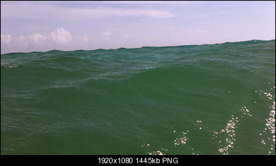

    The Kodak PlaySport Zx3. Boasts the ability to record 1080p video underwater. Shrug. That it does. But here is a frame of that video (no filters, directshowsource):
    At 29.97fps it gets 12.3Mbps (AVC Main@L4.2). The quality doesn't seem to live up to the promise of even that humble bitrate. So I've got to try to do what I can to make things look a little better. Step one is to deal with the overall poor quality.
    Actually, the above frame looks a lot better than it did in KM Player. I can only assume that KM Player was failing some sort of process and causing the image to look way blockier than it needed to. So I don't even know if I should be trying to deblock the image. Maybe there is nothing that can be done. I did try a couple of permutations of DeBlock_QED, but if it did anything at all to the image, the effect was too subtle to discern. I also found an interesting script, with some impressive results posted later on, in this thread:

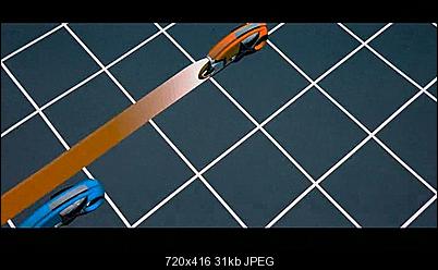

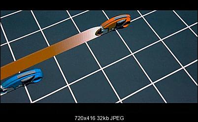

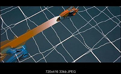

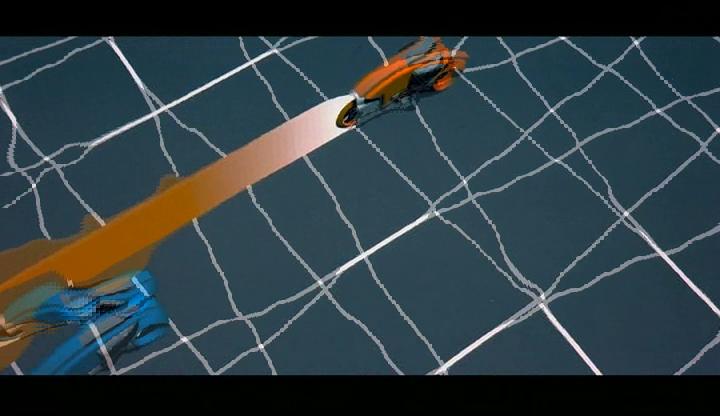

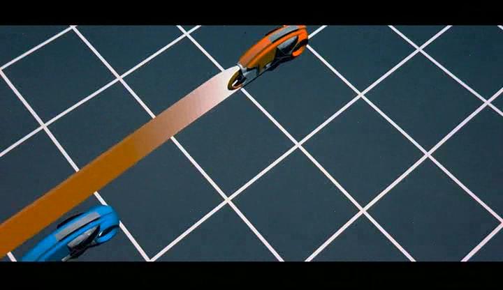

  6. When the motion estimation techniques can't find obvious motion vectors they resort to blending. With non linear motions they often misidentify motion and you get weird distortions. An extreme example:
    source frame:
    motion interpolated frame:
    next source frame:
    That was done in AviSynth with this function:
    function DoubleFPS2(clip source)
    super = MSuper(source, pel=2, hpad=0, vpad=0, rfilter=4)
    backward_1 = MAnalyse(super, chroma=false, isb=true, blksize=16, searchparam=3, plevel=0, search=3, badrange=(-24))
    forward_1 = MAnalyse(super, chroma=false, isb=false, blksize=16, searchparam=3, plevel=0, search=3, badrange=(-24))
    backward_2 = MRecalculate(super, chroma=false, backward_1, blksize=8, searchparam=1, search=3)
    forward_2 = MRecalculate(super, chroma=false, forward_1, blksize=8, searchparam=1, search=3)
    backward_3 = MRecalculate(super, chroma=false, backward_2, blksize=4, searchparam=0, search=3)
    forward_3 = MRecalculate(super, chroma=false, forward_2, blksize=4, searchparam=0, search=3)
    MBlockFps(source, super, backward_3, forward_3, num=2*FramerateNumerator(source), den=FramerateDenominator(source), mode=0)
