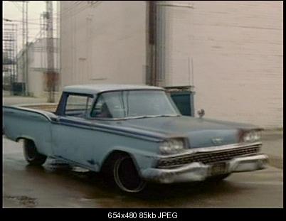

    This interlaced frame of video:

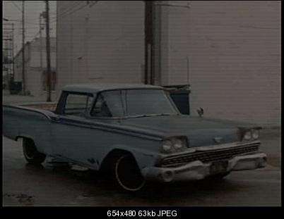

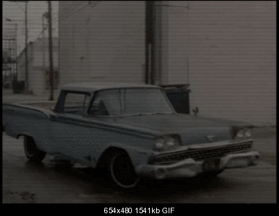

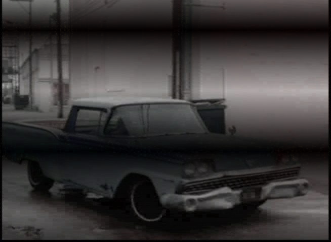

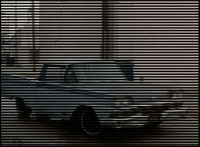

    contains two fields:
    Click on the images to view them full size. Note how each image only contains half the picture. There is a black line between each line of picture information. It's a little hard to tell looking at two separate image but when when you switch back and forth between them you can see that the car has moved between the two fields:

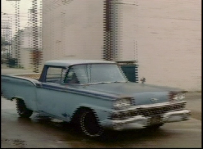

    Again, click on the image to see it full size and animated.
