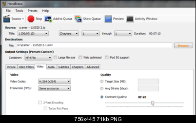

  5. Member edDV's Avatar
    Mar 2004
    Northern California, USA

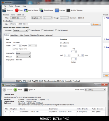

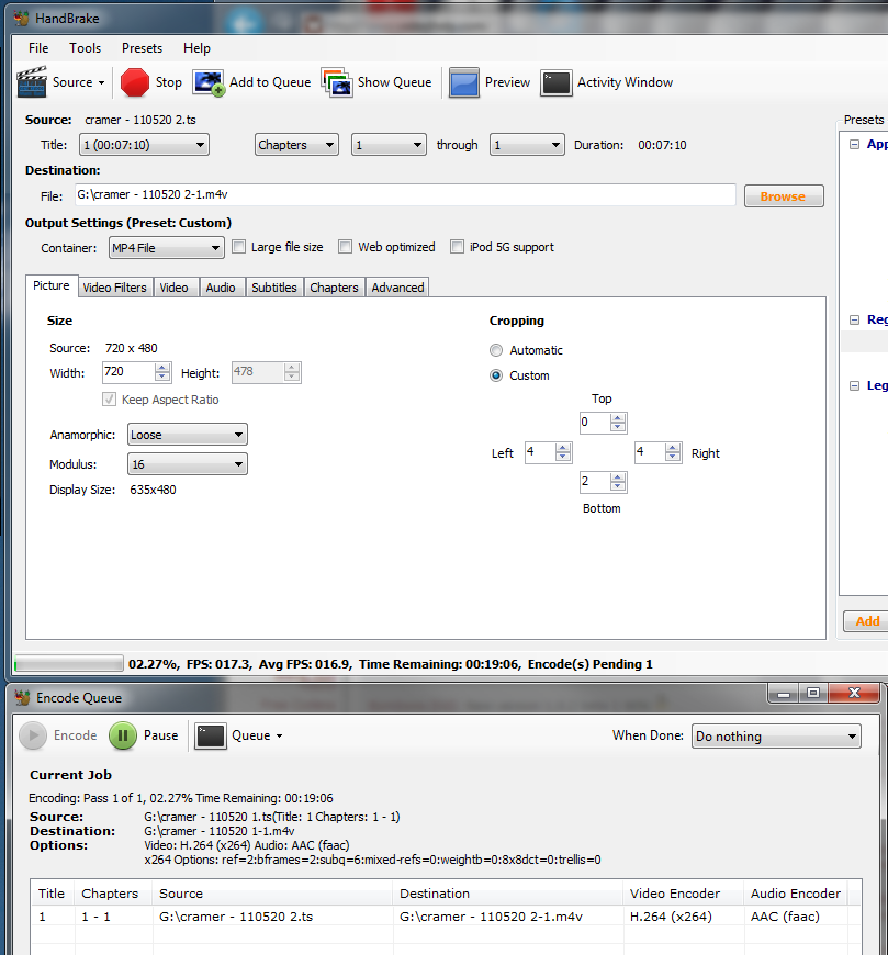

    1. Find source file in "Source" select "Open".
    2. Browse and name destination file.
    3. For interlace out, all video filters should be off.
    4. Press Start to start the first file encoding.
    5. Find second source file in "Source" select "Open"
    6. After it is analyized, select "Add to Queue".
    7. Repeat for other files.
    9. Click "Show Queue" to see the files in the queue.
    http://www.kiva.org/about

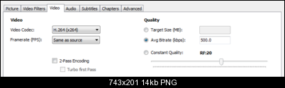

  6. Member edDV's Avatar
    Mar 2004
    Originally Posted by nymph4444 View Post
    Could this be why when I used Format Factory and I set bit rate to 1000 kbps and then picked Interlace to YES
    The video played back in two videos on on top of screen and one video at bottum of screen?
    The bit rat is to low?
    What sould a good bit rate be for mp4 that is converting a VOB file?

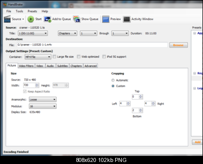

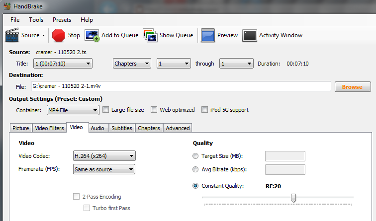

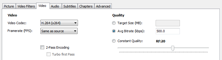

    If you don't select a destination, it will put the encoded file in the same folder as the source.
    Bit rate is determined by the program. If you want a smaller file, increase the constant quality number.
    Alternately, you could check "Average Bitrate" and enter 500 kbps. This gets you VBR.
    Constant Quality will get you a better picture quality encode.

  8. With bitrate based encoding you specify the bitrate but you don't know what the final quality will be. With quality based encoding you specify the quality but you don't now what the final file size will be.
    They are two sides of the same coin: If you perform a quality based encode and it happens to come out to 1000 kbps, then perform a bitrate based encode with a bitrate at 1000 kbps, the two videos will look about the same.
    Use bitrate based encoding when you want a specific file size. Use quality based encoding when you want a specific quality.
  9. OK first off it worked.
    Now why can't I type in 500 in the Bit Rate Box?
    And leave Target File Size box alone?
    Why want it let me do what I want or can I?

  10. Member edDV's Avatar
    Mar 2004
    You can. But 500 kbps will get poor results.
    What bitrate did CQ mode give you? Check with Mediainfo.

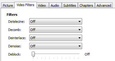

    To output interlace you keep all filters set to OFF. To output progressive set deinterlace to "Slow" or another selection.
    The slider has nothing to do with deinterlace. It is a deblock filter control.

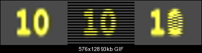

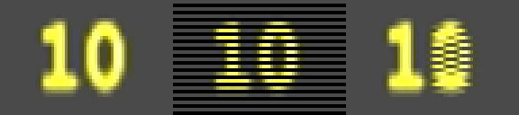

  21. A full NTSC image would be 720x480. An interlaced NTSC frame consists of two separate 720x240 fields. So each field is half an image.
    Here's an example of a crop from a video enlarged 4x with a point resize filter (so each pixel of the original is 2x2 pixels in this sample) and slowed to 1 field per second:
    On the left is the "real world" changing at 60 times per second. In the middle is how that would be displayed on an interlaced TV. Notice how each field is only half a picture (every other scanline; the other scanlines are left black). On the right are pairs of fields woven together into frames (30 frames per second) as they would appear in a digital file.

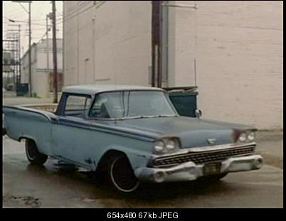

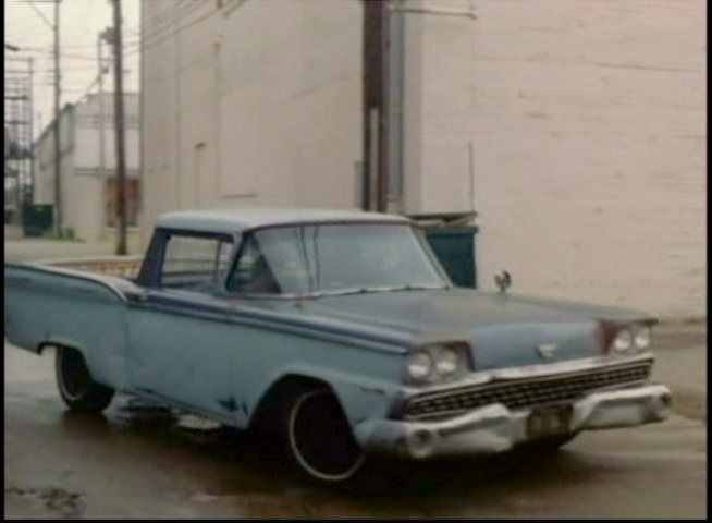

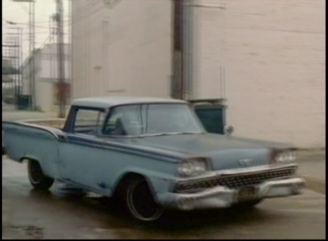

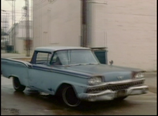

    Here is an example of a telecined movie (Paris Texas) viewed on a 480i Vegas timeline.
    Note the Ford is advancing in motion each frame. Look at the motion vs. the trash can.
    Video frame 1 gets both fields from the same film frame 1.
    Video frame 2 gets the odd lines from film frame 1 and the even lines from film frame 2.
    Note the double image. Check the power poles.
    Video frame 3 gets odd lines from film frame 2 and even lines from film frame 3.
    Also shows double image...
    Video frame 4 gets both fields from film frame 3.
    Then video frame 5 gets both fields from film frame 4 and the sequence repeats. For telecine video, you will always see two frames with split fields followed by three frames with both fields matched to a film frame (no split).

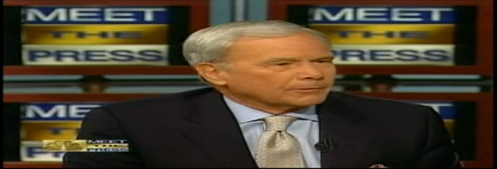

    You need to describe the context of the player and display. A single field extracted from a DVD VOB or captured from NTSC/ATSC broadcast will be a 720x240 or 704x240 raster. If you displayed that as a still on a square pixel computer monitor it would look like this.
    If you paused an old VCR to a SD interlace CRT monitor you would see a 4:3 image with half vertical resolution. A high resolution SD monitor would show a black line every other line.
