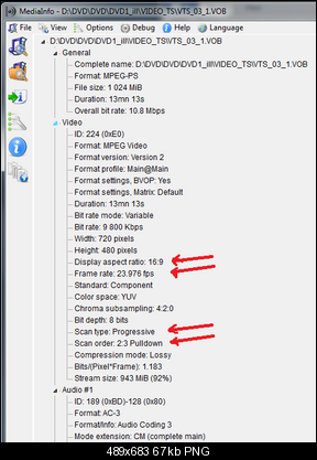

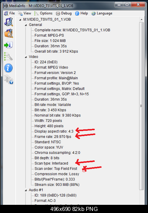

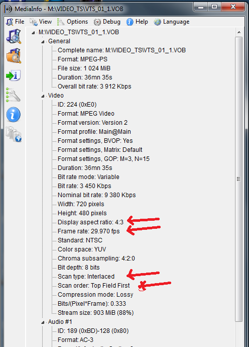

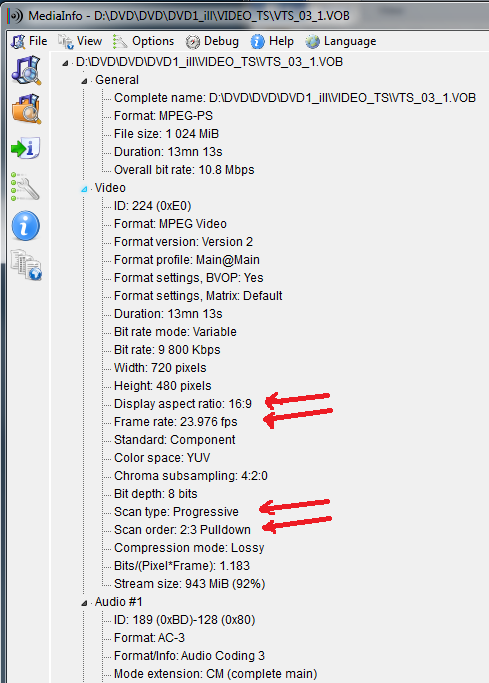

    To be sure, open the VOB for each in mediainfo and check the details. I'm showing tree view.
    For example, I've selected SCTV (Second City) to represent an interlace DVD. This series was shot in a TV studio with TV cameras.

    This next VOB is a typical movie shot on film. I'm guessing your Buck Rogers is similar. Note 23.976 fps, progressive with pulldown flag.

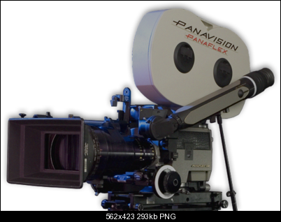

    Yes in those days all 24 fps film cameras used film that had to be developed. TV series like Buck Rogers would be shot with cameras like this Panavision. Each film canister was good for 10-15 minutes of 35mm film.
    TV news operations shot with 16mm cameras like this. Each TV station had its own film processing lab and projected film to TV live on these projector to TV camera telecine islands.

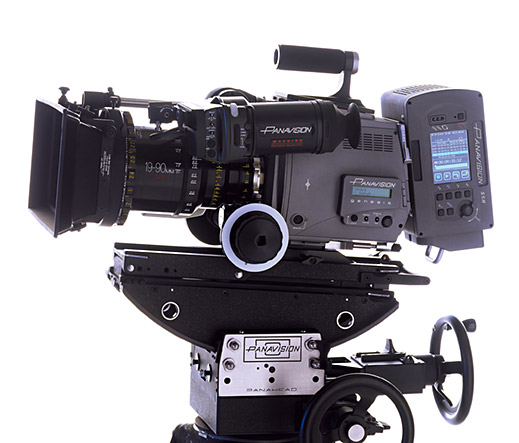

    Today TV series can be shot traditionally on film or with HD TV cameras like the Panavison Genesis. The box on the back of the camera holds hard drives or flash RAM drives.

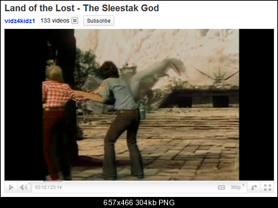

    Many of the "Land of the Lost" effects scenes were shot on a chroma key stage. This way the actors shot against blue could be electronically placed (keyed) into miniature sets along with stop frame animated characters.

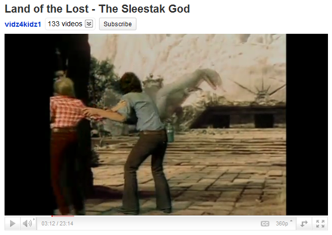

    Example of chroma key scene in "Land of the Lost".
    That animated Tyrannosaurus model was probably about a foot tall and the background set was small.

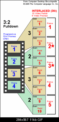

    But you told me TV was Telecinde or something like this what is that?

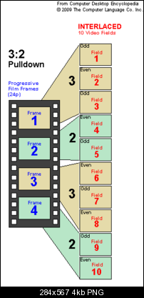

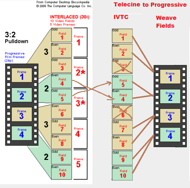

    You've been told this several times already. 24 fps film frames go through 3:2 pulldown to make 59.94 fields per second for interlaced TV.

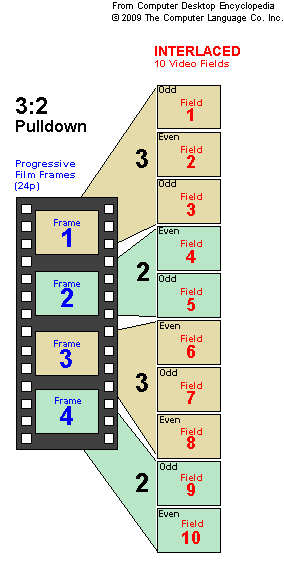

    Remember this?
    This is how 24fps (run 23.976) film is converted to 29.97 frames per sec for TV.
    To return the 29.97 frame rate to 23.976 progressive, one needs to attempt inverse telecine (remove dup fields). For some types of programs (e.g. Buck Rogers 70's) this can be done. For others that were 29.97 native or mixed format, it can only be done with advanced techniques if at all.
    In film terms "pulldown" means the rate of projector film frame advance to the gate is slowed so extra fields can be scanned to 3 fields, then back to normal speed for the normal 2 fields. To understand this you need to understand projector gates.

    It's common for a "progressive" DVD to have interlace extras. One needs to run mediainfo on each selection.

    For the record, we have been mentioning inverse telecine (IVTC) as a way to reverse 59.94 fields per second telecine back to 23.976 fps progressive frames. Every HDTV set uses this process to convert 480i or 1080i telecine to progressive for display. Here is a diagram of the process.
    Inverse telecine begins with analysis and synchronization of the telecine pattern. Then the repeat fields (3 and 6 in this drawing) are deleted and fields 4 and 5 are reversed in order to maintain an odd-even-odd-even field sequence.
    The resulting 8 field sequence is exactly the way progressive video is stored on DVD (i.e. as fields). A simple weave deinterlace results in progressive frames at 23.976 fps. DVD players convert 23.976 to 59.94 fps for output. They do this by repeating frames in a 2-3-2-3 pattern for analog component or HDMI output. "60 Hz" HDTV sets convert 23.976 progressive frames to 59.94 fps in the same way. "120 Hz" HDTV sets repeat 23.976 five times to 119.88 fps for display.

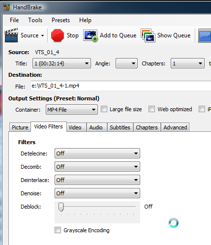

  27. OK I got Handbreak the verson you gave the link to.
    No I will tell you what I want to do and you can tell me how to do it.
    I have a Mach Speed Trio 5000 with a 5 inch LCD screen. And it will let me output my video media to a TV HDMi port.
    Now I have some VOB files I Decrypted from my DVDs I got of like I say 1970's tv show Land Of The Lost.
    I would like to convert them to the smallest file size but still have good video picture.
    So I would Like to use
    MP4 H264
    640x480
    29.97 fps
    44.1 Hz 128 Bit Stereo
    Video Bit Rate 500 Bits Per Sec.
    And can I do a fue video files at one time or if I do will they be linked togather?
  28. I got Handbrak and it seem to work for my test.

  29. Can you convert a lot of files to mp4 in Handbrake or will Handbrake make one big file out of them?
  30. Member edDV's Avatar
    Mar 2004
    Northern California, USA
    Handbreak encodes one input file at a time. The output file is the same clip as the input.
    You can stack (batch) files in the Queue. They will execute one at a time. You can add more files to the queue while the encoder is working.
    I suggest you test encode interlace and a second test with deinterlace slow, then compare the media player for deinterlace artifacts.
