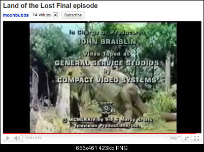

    So that is the big picture but we are still at step 1.
    We are near 100% certain that the "Land of the Lost" TV series is normal interlace although there may be some 23.976 elements in the effects sequences. How do we know this? First Mediainfo reported 29.97 fps. That is all the information you've told us so far. Second I researched the production history for the series and found the stage scenes were shot at a film studio lot* but with video cameras from Compact Video of Burbank**. We also know Compact Video composited the effects scenes in video equipment. It is not known whether the stop frame puppet animations were done at 29.97 or 23.976 rate or less. This could be determined by further frame by frame analysis.
    * General Service Studios in Hollywood now known as Hollywood Center Studios.
    ** Compact Video specialized in mobile video production equipment that could be used on a film lot or film stage. By doing so, a producer could use all the props and services of a film studio but shoot and edit in less expensive video format. They pioneered the methods later used for HD TV series production today. And this was in 1974.
