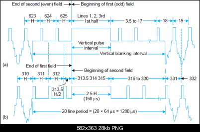

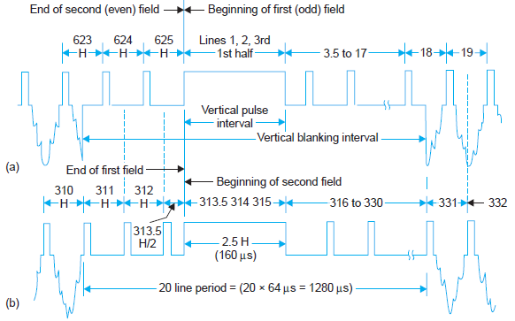

    You are still confusing digital file format structure with analog video. As Jagabo said, analog just alternates odd and even line fields. The way the TV (or capture card) knows the odd from even field is the position of the vertical sync pulse in relation to equalizing pulses as shown here.
    http://www.bewinstar.co.cc/2010/11/experiment-iii.html
    Note that this picture is for 625/50 PAL but NTSC (RS-170A) is similar.

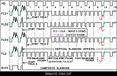

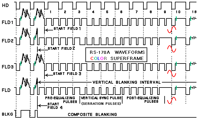

    Here is the four color field sequence for NTSC RS-170A. Composite NTSC has a four field color frame. Componet analog or digital only need two fields to complete a frame so can be edited at the frame.
    http://www.ntsc-tv.com/ntsc-index-02.htm
    A composite PAL colour frame consists of eight fields.
    Digital video uses different techniques to identify field one from field two using data flags. Digital video file formats can be stored TFF or BFF. So, in addition to field one vs field two flags, an editor program needs to know which field is to be read first for file playback. Edit programs need to match various BFF and TFF video files as a layered composite.
