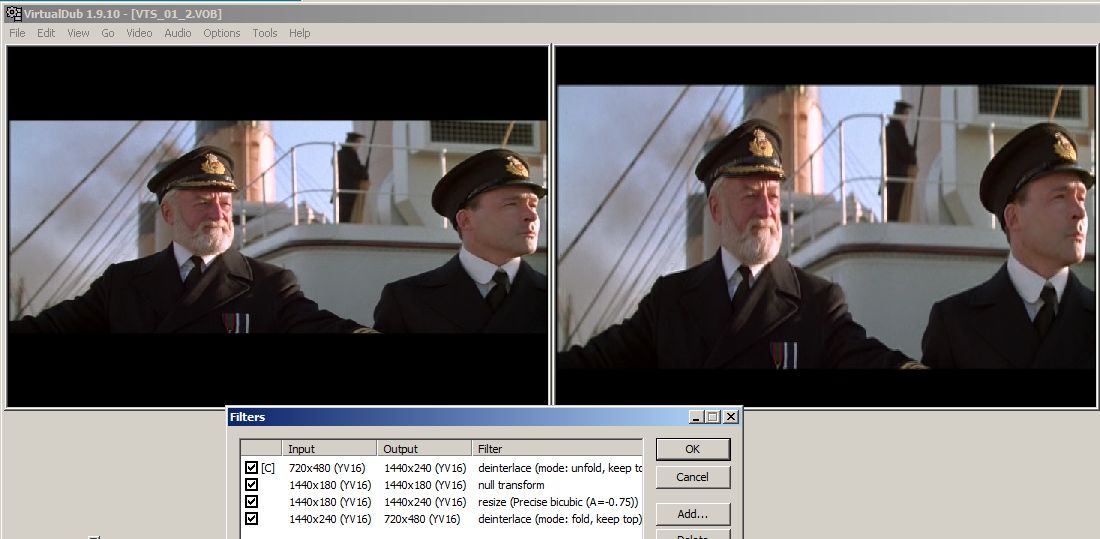

    I removed 30 top and bottom then resized 1440x240 using absolute pixels - it doesn't look right.

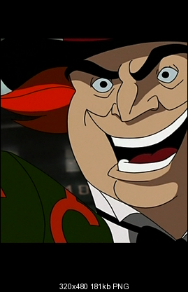

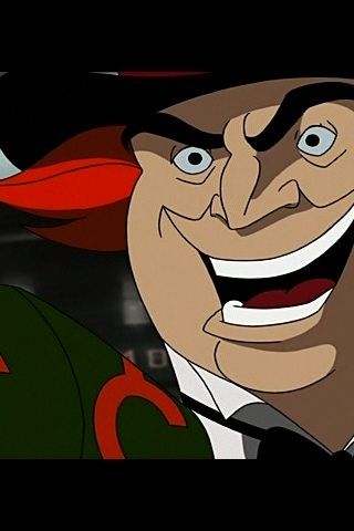

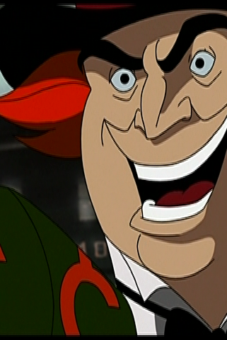

  8. It's not supposed to look right. VirtualDub shows you the result as square pixels (unless you override the display aspect ratio of the output window). A 16:9 DAR 720x480 frame should look horizontally squished when viewed as square pixels. If you want to see it as 16:9 DAR right click on the output pane and select 16:9 Frame.
    Since you're working with film based material you should inverse telecine back to the original film frames. That will give you better resizing and compression. For example (these are 360x480 crops of the 720x480 frames, just to make the files smaller):
    interlaced source frame:
    deinterlace/crop/resize/reinterlace:
    ivtc/crop/resize:
    The problems are especially obvious with animation because of the sharp high contrast edges. It's less noticeable with real world video because it tends not to have such sharp edges.

    Ok, I see the correct AR after changing the view in VirtualDub.
    The original script from DVD Rebuilder crops 30 top and bottom from the source.
    Is this an arbitrary number, because it looks like in VirtualDub that 50 would be the value to remove all of the border - but then I can't figure out the resize values.
    How does 'ivtc/crop/resize' resolve to a 16:9 image.
    When I crop 50 from top and bottom (to completely remove the border) and resize using absolute values (720 X 480) it just stretches it vertically.
  10. The DVD-RB script crops 30 from the top and bottom of the fields (not the source). If working with the full frames (after an IVTC, for example) you'd crop 60 from both the top and bottom of the frames.

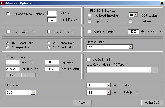

  21. If you've set it up properly in hcenc, mediainfo will say progressive 2:3 pulldown
    Playing it in DGIndex will show video type "film", frame type "progressive"
    I can't remember what gspot says, I think it says I/L and 23.976 pics/s for soft pulldown , but 29.97 pics/s for hard telecine
    You need to hit make "DVD compliant" button in order for HCenc to insert soft pulldown flags (it will auto checkmark 3:2 pulldown box)

  23. I should have mentioned DGPulldown can do this a lot quicker instead of re-encoding (assuming you set everything else in HCEnc correctly)
    In HCEnc, the "make dvd compliant" button fixes other things too , like GOP proper length
