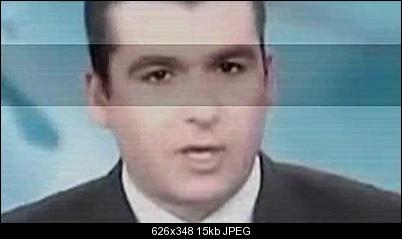

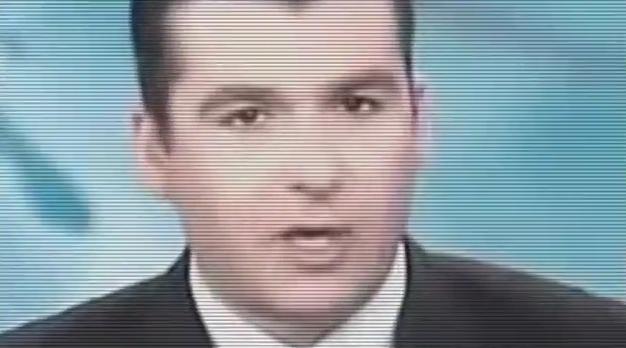

  6. Are you talking about something like this:

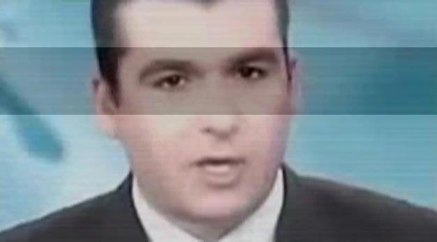

    or like this:
    (The dark or light band usually scrolls up or down the screen.)
    These are both defects seen when filming a CRT display (in movies they are often simulated, ie, they aren't really made by shooting a TV, they shot on film normally and added the effects later). Both are caused by the nature of the way the CRT is scanned by the electron beam -- each phosphor dot glows when it is scanned but quickly fades. LCDs don't show this type of problem because they aren't scanned, the backlight is on continuously and the picture stays on the screen until it's changed.
