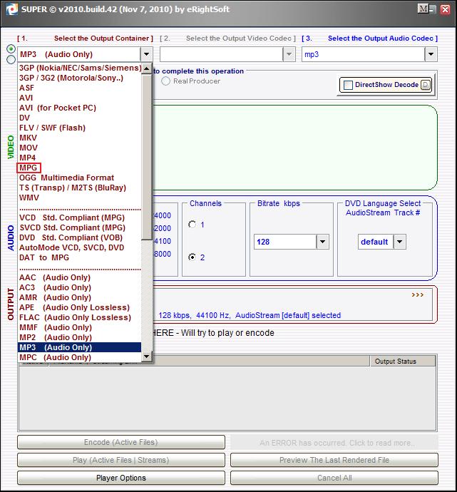

    I do have a converter known as Super on my computer. I have attached a picture, to my post. The option in the red box appears to be MPG. Is this the extension for the MPEG file type? (If not, is AVS Video Converter a good option? I've heard that you have to pay for it, but you can use it for free also. Does this mean that it leaves a watermark, or something else, until you pay for it? because that would not be worth it to me.)
