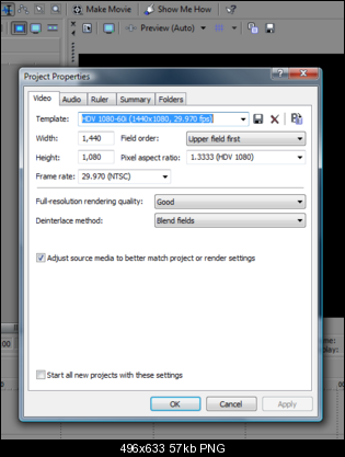

    Here is the HDV project setting for Vegas Movie Studio Platinum 10. As you can see, it sets the timeline resolution to 1440x1080i and aspect ratio to 1.333.
    If you import 1920x1080i or other resolutions to the timeline, right click on the clip and check Properties. It should show its native resolution and aspect ratio. From then on Vegas will manage everything. For example, if you export to 1920x1080i Blu-Ray, Vegas will scale 1440x1080 clips but not the 1920x1080i clips.
