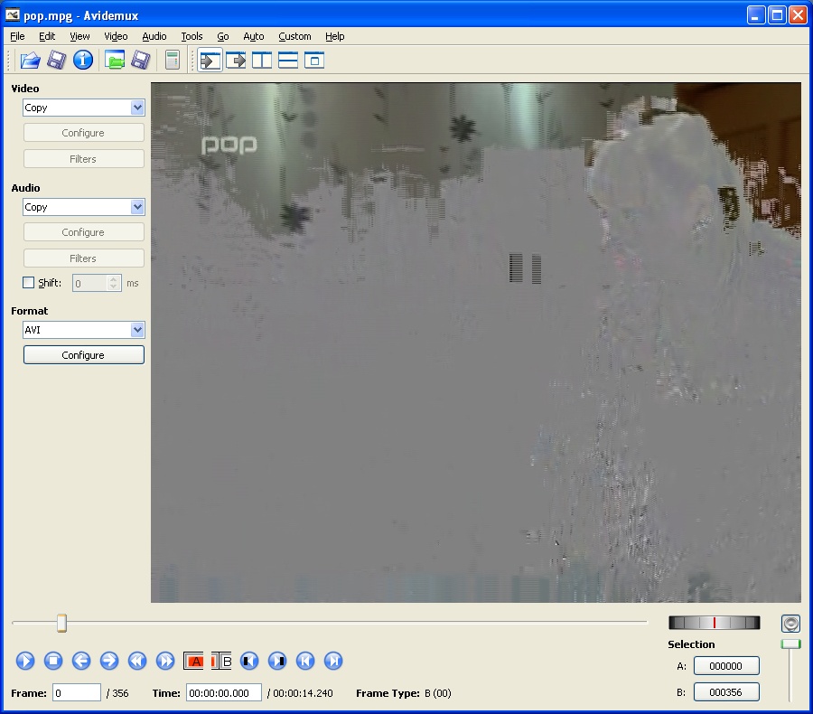

  5. Avidemux opens the file but show garbage. (Seems just like ghost image)
    File is recorded from DVB-T receiver. And all transmission here are MPEG4 H264. Audio seems to be non consistent. (not same on all channels)
