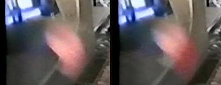

  13. Here's an example of the chroma problem:
    On the left is one frame. On the right is the next frame. You can see that the hand has moved but the colors for the hand have stayed in the same place.
  14. jagabo - I wonder if that is related to the flashing pink lines?
    if you assumetff().separatefields() , each consec. field pair that has the pink, is followed by a gap of orange in roughly the same shape as the defect, as if the chroma was lagging behind a field (or frame if you bob it) . 2pink, 2oranage, 2pink, 2orange...

  26. Originally Posted by jagabo View Post
    [Attachment 6746 - Click to enlarge]
    I've run into this problem with some 8mm tapes. I thought it was artifacts of the player's temporal noise reduction, but the chroma ghosting remained even with it off. It seemed to be embedded in the tape as the problem occurred with multiple playback devices.
  27. Originally Posted by NJRoadfan View Post
    The most common cause of this problem is handling interlaced YV12 as if it was progressive. For example, if you open an MPG file in VirtualDub and apply any filter that requires RGB, VirtualDub will treat the interlaced chroma channels as progressive when it converts to RGB. That will generate this chroma problem.
  28. Originally Posted by jagabo View Post
    I'm seeing it with raw YUY2 encoded HuffYUV captures with no filters and outside of VirtualDub. I'll run a few more tests when I get time.
